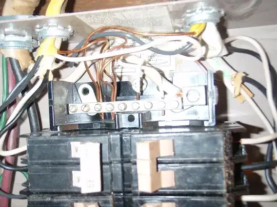

In an inspection report on my house, the inspector said "hot and neutral" are not separated. I think he meant "neutral and ground" are not separated. I've attached the picture, is that the case? enter image description here

    If "hot and neutral" are not separated you just get a short. – sharptooth Mar 05 '13 at 07:20
    Nobody can answer this without more information because if we guess and give you bad information then you could potentially create a dangerous situation. We need to see if it is a main service panel by looking at the main breaker. We need to see if there are more than one buss. What country are you from and what year was your home built? – maple_shaft Mar 05 '13 at 12:39
    @sharptooth Well he would probably get a short, but then I see in the picture that there are double pole breakers with white wires connected to them, and they are not AFCI breakers. It is *possible* that one of those "hot" white wires is connected to the bus but without seeing the whole breaker box we can't tell for sure. – maple_shaft Mar 05 '13 at 12:43
    @maple_shaft Just by the simple fact that it's a 4 wire feeder, you can probably safely assume this is a sub-panel. – Tester101 Mar 05 '13 at 13:32
    It's a sub-panel, and I am in the US (Maryland to be specific). – themidnightwill Mar 05 '13 at 14:10
    @themidnightwill Could you please provide an image that shows the whole panel? Is there an additional bus bar in the panel? I'm guessing there is a separate equipment grounding bus bar, which the green wire from the feeder is attached to. If there is not, you'll have to install one. – Tester101 Mar 05 '13 at 15:33
I'm guessing from the image that this is a sub-panel, in which case the inspector is correct. The National Electrical Code (NEC) says:

(5) Load-Side Grounding Connections. A grounded conductor shall not be connected to normally non–currentcarrying metal parts of equipment, to equipment grounding conductor(s), or be reconnected to ground on the load side of the service disconnecting means except as otherwise permitted in this article.
Which means the only place the "neutral" (grounded conductor) is bonded, is in the main service panel. If the grounded (neutral) and equipment grounding conductors (EGC) are bonded anywhere else, you can end up with neutral currents on the EGC and metal parts of equipment which is a violation of 250.6(A).

After taking another look at this, he could mean that the white insulated wires are not marked appropriately. When you use a wire with white (gray, or with three continuous white stripes) insulation as an ungrounded (hot) conductor, you have to mark the wire in some way to indicate that it is not used as a grounded (neutral) conductor.

Since the white wires connected to the breakers are not marked, it looks (to the untrained eye) as if the grounded (neutral) conductors are connected to the hot bus. The most common way to mark the wires, is to wrap a bit of black electrical tape around a small section of the wire.
    So it is a sub panel and the inspector was right per NEC, however what is the best way to resolve this issue? If there isn't a seperate buss how would the OP install one? – maple_shaft Mar 05 '13 at 14:16
    @maple_shaft Depends on the manufacturer of the panel, some offer "add-on" bus bars which can be mounted to the panel. – Tester101 Mar 05 '13 at 15:20

  • Manufacturer specs cannot override the code requirement to separate neutral and ground in a subpanel. Most panels have separate bus bars that can be purchased and added on to allow the separation. The neutral bar (probably the new one) would be insulated from the panel frame to be properly installed. – Skaperen Mar 15 '13 at 06:34
  • I see white wires going into breakers. This does not comply with code. The wires should be "marked" with a permanent tape around them. Any color legal for hot can be used (black, red, blue). The marking must be on both ends. Technically it is supposed to be done at the time the whole cable is installed. – Skaperen Mar 15 '13 at 06:36

It would help if you told us where you are, and what you are showing us a picture of.
If it's a main panel, neutral and ground and bonded together. If it's a sub-panel, neutral and ground must be kept separate.

    I don't see a main breaker in the pic. I see the large black and red going down the left side of the box, but pic doesn't show a separate neutral and ground buss. – shirlock homes Mar 05 '13 at 10:42
  • Yes, this is a sub-panel. If my memory serves me correct, the black and red are attached to the main panel. – themidnightwill Mar 05 '13 at 14:11
