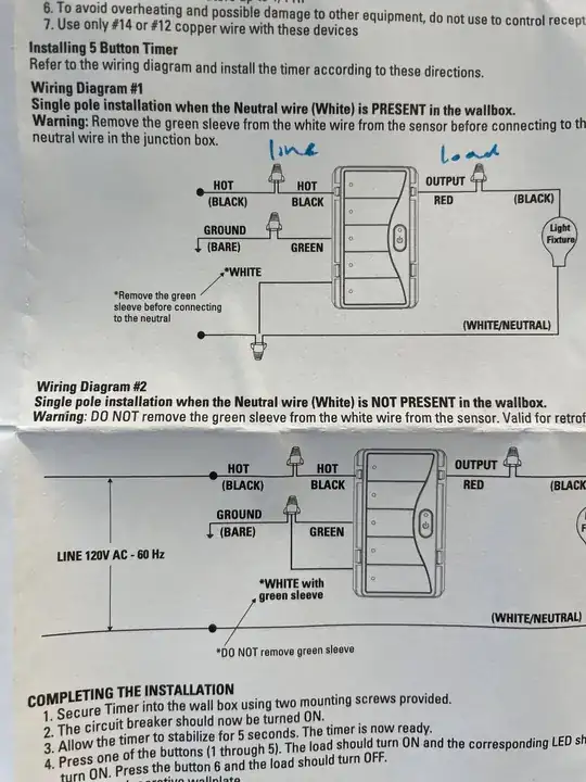

Here's the wiring diagram from the instructions; I used option 2:
wiring diagram
Since some of the comments have questioned the instructions regarding the neutral wire, I searched the product reviews and found this: "It uses the ground as neutral (!) to power the electronics inside the switch. That's pretty bizarre even if the current involved is minuscule." Given that, it does make sense that you would connect a neutral wire to the timer if available, or connect the ground wire to both the neutral and ground on the timer if not. Since the timer does function correctly with the light off, that part seems correct, but what happens when the light is turned on that apparently removes power from the timer?

    The instructions say to connect white and green to ground when there is no neutral wire. The fan previously worked when the light was on or off. – arlomedia Sep 28 '22 at 22:14
  • @arlomedia You have a neutral wire and you are misinterpreting the instructions. – Robert Chapin Sep 28 '22 at 22:20
  • @arlomedia Ignoring ground for this question, were there only 2 wires attached to the old timer switch, or more than 2? Yes, the instructions meant "no neutral *in the box*" not "no neutral *going to the old switch*". However your switch problem is because the *always-hot* wire is only serving one switch, when previously it served both switches. Something more is going on. that you haven't stated. Possibly something you consider unimportant. – Harper - Reinstate Monica Sep 28 '22 at 22:23
  • There were only two wires going to the old switch. They were labeled, on the switch, Line and Load, and I connected them to the black and red wires respectively on the new switch. There was a free (not connected to anything) ground (bare) wire in the box, so I connected that to both the green and white wires on the new switch. If there's a neutral wire in the box, I don't know how to identify it among the tangle of white wires packed into the back; besides that ground wire, I don't see any other free wires. The switch instructions say a ground is required but a neutral is not. – arlomedia Sep 28 '22 at 22:33
  • I just added a photo of the wiring diagram that came with the new switch. – arlomedia Sep 28 '22 at 22:43
