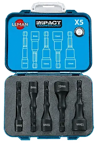

It's possible to buy impact-rated sockets with a hex shaft to mate with your impact driver.
Advantages: simpler, lighter if you have one or two, and the impact driver bit holder will grab them properly so unlike the adapter+socket solution it avoids the embarrassing situation where the socket stays stuck on the bolt then falls off, which is inconvenient when you're on a ladder, or if it falls into the machine you're working on.
Drawbacks: they're a bit more expensive, and if you have several, the lot will be heavier and take more space in the toolbox. And they're not compatible with a socket wrench. So you end up with two sets of sockets.
