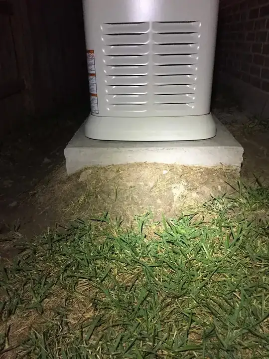

Went through Costco to get a generator installed. Generac 25kW. That was a mistake. The contractor they use has been nothing but problems.
I got a pad poured to exact dimensions but yet these guys managed to mess up the placement of the generator. It is off center, 1.5" on one side and 2.5" on the other. Also, it is out of code. It should be 36" from the fence on the left side, it is 35.5". It should be >=18" on the right, is 19" which is ok on that side.
Problem is that it is anchored in with two lag bolts on the left side of the generator. Would it be a problem drilling two new holes .5" from the old holes? My concern is the concrete cracking due to the spacing. Also, water getting in the old holes and expanding during freezing winter.
Right now it is the contractor's problem and needs to be fixed. If I don't address this now and wait until I sell the house, it will be my problem.
How would you CORRECTLY fix this problem?

    centering doesn't matter. If the inspector goes cites you for 1/2" hit that skirt with a sledgehammer a few times. – gbronner Oct 14 '22 at 04:57

I would leave it as is unless the inspector requires that it be moved 1/2 inch. You can try drilling new holes but that close to the old ones I would not expect it to be successful. If it's not successful you can drill a bigger hole and set a stud with epoxy. You could also mount the generator to pressure treated wood and then fasten the wood to the concrete.

    I would leave it too. And consider moving the whole pad if you have to (and you can get leverage to move it). – Steve Wellens Oct 14 '22 at 04:50
    To elaborate: Get pressure treated wood. Make holes for the existing lag bolts, then put new holes 1/2" away. Put the treated wood on the existing lag bolts, and bolt the wood in the new holes to the generator. You will need a drill press. – gbronner Oct 14 '22 at 05:00

  • so drilling holes 1/2" from the previous holes will cause the pad to crack? – amrog Oct 14 '22 at 15:12
  • It won't crack the pad but if you put a lag bolt right next to an existing hole that hole might break out into the adjacent hole. – Platinum Goose Oct 14 '22 at 17:42
