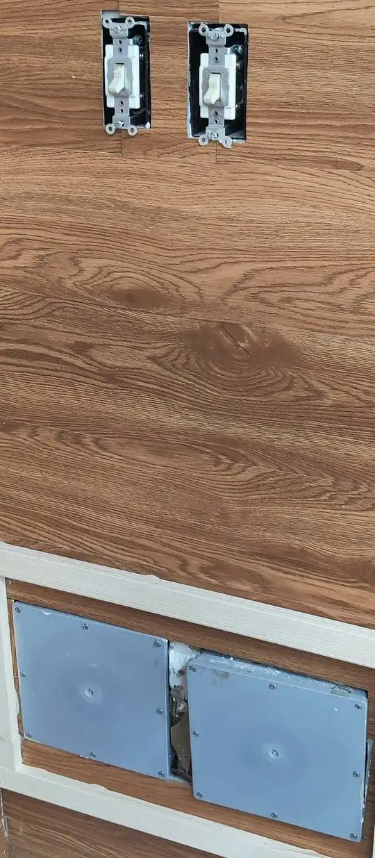

EDIT 2: ISSUE FOUND So we found the issue, it was two switches in the garage that turn on nothing in the house, but the house was using 6 KWH/ hr and after switching it off, it went to less than 1 KWH/ hr. These switches turn on two small boxes that seem to only heat up a lot (hot to the touch) but does nothing else. Have no idea what they are for. Can someone explain what this thing is for?.
Switches with boxes
Edit 3: Opened boxes enter image description here
Sorry for slow update. After finding the cause, we went straight to work on the patio and didn't check the thread till after I left. My brother opened the box for you guys here. Appears to be a bunch of heavy duty cables for high voltage. Still not sure where this even goes though, so we are probably going to box off the two switches and change them to smart switches so we can remotely monitor and turn them off if they ever turn on again. I would love to investigate what these are for in the future in another post.

  • Maybe you should open the lids and see what is inside those boxes. – UmH Oct 17 '22 at 16:44

    One wonders if those cables don't feed a heater somewhere. – Hot Licks Oct 17 '22 at 18:05
    Heated driveway is my guess. If so you won't find any "device" or the other end of those cables anywhere. But your driveway will be warm. The boxes shouldn't be warm ... that also could be another question. And most smart switches don't support this much current so watch what you buy. – jay613 Oct 17 '22 at 18:14

    @SteveSummit The house is in a mountain range with snow and ice, so I do believe that it is possible they could be for snow melters as mentioned in other comments. – Tai Oct 18 '22 at 07:25
  • Bingo. Looks like a snow melt system. Automatic ones usually start to kick in when outside temps dip to around 37 degrees F, but that looks like a manual system controlled by those heavy-duty switches. – Chris O Oct 18 '22 at 14:36
