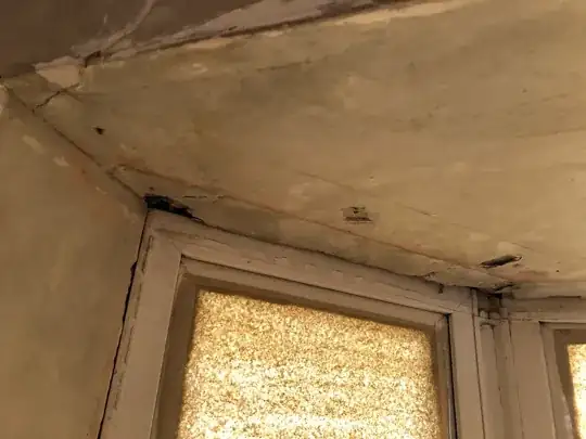

I currently have unused coaxial cable wired into all rooms in my house. They were used for satellite TV. The thicker cable in the photo is either RG6 or RG59 cable. The thinner cable is the type used for landline telephones (RJ11/RJ45).
Existing coaxial cable

  • Presuming it's RG6 (? ... looking at that connector from the 80s; it might not be). You cut one of the cables, then put modern ends on the other cable, with a $40 pair of pliers, after you scrape the varnish off the inner core. Do not buy BS connectors. Buy the ones that require the $40 tool. If RG6 connectors don't attach tight after you crimp them, then it's not RG6, and then you get what you get unless you run actual RG6. All that being said, running wire is silly no matter what kind it is; **get mesh wifi**. – Mazura Oct 28 '22 at 01:49

    I run 2.5G MoCA adapters over my in-house RG-6 (you should verify it's RG-6 and not an older spec'd cable) and it can get 2200MBPS with virtually no added latency. It very surprising to see how great it was. – WannabeCoder Oct 27 '22 at 03:16
