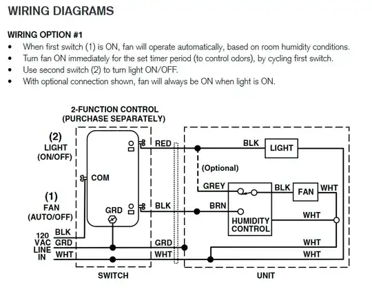

Wiring diagrams from manual: enter image description here enter image description here

Your electrician is most likely wrong. It sounds like your original setup was like this:
  1. Power comes into your switch box and connects to two separate switches (one for the light and one for the fan)
  2. There are probably 3 wires (not including the ground wire) running from the switch box to the old unit (probably a black, red and white wire).
  3. The white would be the neutral, and the other two are the hots for the light and fan. If this is the case, you will need to wire the new unit up as shown in option #1. (You would need 1 more hot wire to use option #2).
For option #1 you do NOT need a special double switch. You can simply use the 2 switches you have (the "special double switch" just fits 2 switches into a single space). Either way, this is how the unit will work.
Fan Switch:
  • Off- Auto humidity control is off
  • On- Auto humidity control is on
If you want to manually turn the fan on - switch must already be on, then flip the switch off then quickly back on (unless you turn it off, it will run for the set time).
Light Switch: (no jumper between black and grey)
  • Off- light is off
  • On- light is on
Light Switch: (jumper between black and grey)
  • Off- light & fan are off
  • On- Light and fan are on
Regardless if you use the jumper or not, the light switch has no effect on the fan switch.

To answer this question in case anyone is curious: The electrician was wrong. I have the Same Setup as OP where I have a switch for the fan, and a switch for the light in my bathroom setup. There are technically 3 sets of wires: One set for the light, one set for the fan and humidity sensor, and one for the optional always on function of the fan (which is a grey wire).
I think the problem with Braun's instructions is that it's overly complicated and they make it seem like you have to buy their double switch (https://www.amazon.com/Broan-NuTone-P2RW-Two-Rocker-Control-Bathroom/dp/B0886KMV8T/ref=asc_df_B0886KMV8T/?tag=hyprod-20&linkCode=df0&hvadid=459579282194&hvpos=&hvnetw=g&hvrand=8796256200313532447&hvpone=&hvptwo=&hvqmt=&hvdev=c&hvdvcmdl=&hvlocint=&hvlocphy=9053616&hvtargid=pla-951034361431&psc=1) which isn't the case.
The wiring that went to my fan from the two separate switches comes out of a single 14-3 wire with a ground, white (neutral), black (hot) and red (hot).
All white wires from the vent box would be wired together, as did the green to the ground. Then it was black to the brown, then red to the black.
If you were to wire the grey wire to the light, then the fan will always be on once you turn the light on, hence that optional function.

Option 1 in the following YouTube video by Broan. It’s the same wiring function as this CST80SLW or CST80SL unit: https://youtu.be/KlLB2u_NVCc
