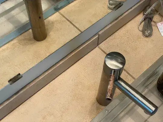

My bathroom faucet is loose on the countertop. It wobbles and rotates when lifting and turning on the water.
Faucet sitting flush on tile

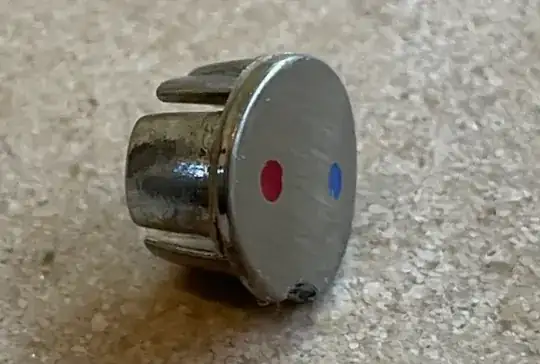

Update: the answer by @Ecnerwal may be correct: I am now in the process of figuring out how to disassemble this (I find) Brizo faucet. I've popped out the hot/cold indicator under the handle…
close up of hot/cold indicator under handle indicator removed

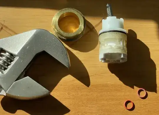

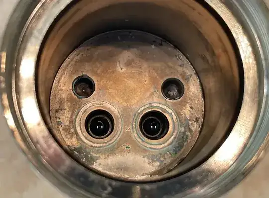

Update 2: I now own a honking big crescent wrench, but did not find what I was looking for. Removing the brass nut gives access to the cartridge for the faucet, but nothing related to affixing it to the counter.
crescent wrench, brass nut, and cartridge with o-rings
interior of the faucet with two holes for water inlet, and two indentations for aligning the cartridge
