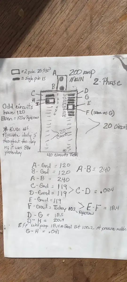

I'm getting readings of 120v and 81v alternating On one side of panel (call it A) and 120 and about 6.8 alternating on the other side (call it B) (all 2 pole 20 amp breakers to service 240 ). Obviously nothing working powered from this side. Some lights and low draw items work (intermittently) from 81v circuits on the other side. (A)

    @Harper -" Alternating ' meaning every other available 120 circuit . "B side" just happens to be all 240 - 2 pole breakers ....yes, zone electric heat. BUT, side A has a couple: well pump and dryer. Obviously, they also are not working. The 16 - 120v circuits are above. On This side every other circuit is 120v & 81v alternating including the 2 - 2 pole 30 amp breakers. As for the other side of the panel (all 2 pole 20 amp breakers) readings are 120v & 7 to 9v. This side alternating / every other 120 circuit. – John Steger Oct 31 '22 at 23:59
  • AND to make things interesting, Back to "A side" since all my lighting is LED a good amount of my lighting is working rven though it s on a circuit with only 81v. – John Steger Nov 01 '22 at 00:00

  • @Harper The ONLY reading that was consistent.. main legs coming into the house. 241v across and each leg to grind 120v. That'was the end of normalcy.. – John Steger Nov 02 '22 at 16:10

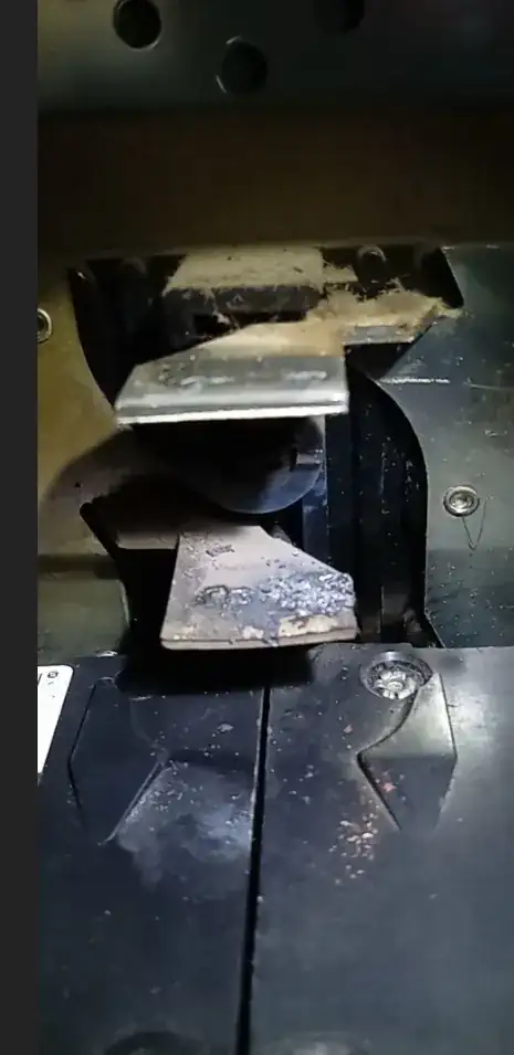

    @GeorgeEnded up being one side of the 200 amp main circuit breaker was trying to weld itself to the buzz bar. Hence all the crazy readings hour by hour. – John Steger Nov 02 '22 at 16:15
Thabus bar in panelnk you for your help folks, I remembered this post and thought I'd use the format to help with diagnosis. With the information provided by systematically checking the entire panel. (And the buzing noise i heard in the process) led me to the main breaker. By removing it, the evidence was pretty clear..
the sketch of my process
