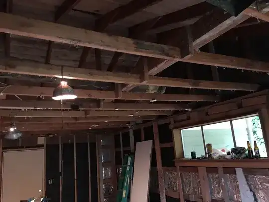

Edit: adding some pictures of the inside tubing. I do hear what seems like water moving around there. flue vent low point

Does the indoor portion of the vent pipe have a low spot? Perhaps it has some bends to get around an obstruction? If so, you may have an accumulation of water that has condensed from combustion gases. If deep enough, flue gases may be intermittently blowing through the standing water.
The cure would be to eliminate the low spot by rebuilding the vent pipe without one.
I've seen this happen in flexible dryer vents that had a long horizontal run through an unheated space and had sagged from the weight of condensed water.

  • OK I added a picture. It doesn't seem like a low spot at first glance, but it might be (I'll have to take a level and figure it out). Regardless, there appears to be water in there, because I can hear it in that corner. I'm not sure if the water is there because of condensation (as you suggested), or because some water got in through the exhaust after some heavy rain... Rebuilding the vent pipe seems expensive. Would you advise against just using a shop vac to get that water out? (Sure, it might return in the future, but that future may be years). – Rodrigo Nov 08 '22 at 22:38
    @Rodrigo Condensing boilers and furnaces sometimes have air pressure sensors on the air intake and/or combustion gas pipe to detect a blockage. A shop vac could overwhelm such a sensor and damage it or knock it out of calibration. If you know someone with a laser level that projects a level line, that will be the quickest way to check if there's a low spot. To drain water as a temporary fix, you can drill a small hole at the low spot in the PVC pipe, let the water run out, then plug the hole with a self tapping stainless steel screw through a blob of silicone caulk on the hole. – MTA Nov 08 '22 at 22:55
