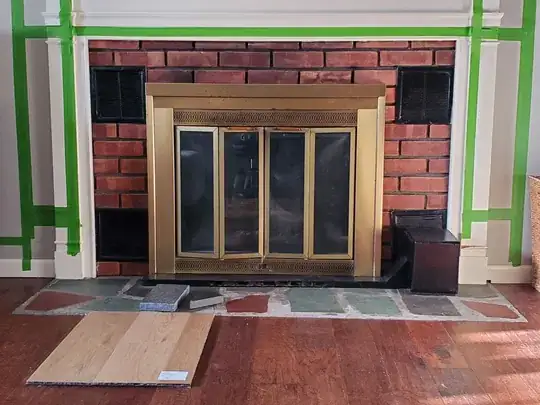

Here is our current fireplace with a concrete hearth consisting of big ugly (our opinion) bluish and reddish stones: enter image description here
I want to tear out just the "hearth" (the stone on the floor) and replace it with some more modern stone (e.g., give it a more modern look).
As far as tearing it out, any recommended approaches other than just breaking it up with a sledge hammer? I guess I'm wondering if hearths are typically glued or fastened to subflooring (or underlayment?) and what headaches I might run into trying to tear it out. Any ideas or is this super simple smash and trash?

    do not use sledge hammer, be more surgical – asinine Nov 07 '22 at 23:07
    use dermal tool with diamond blade and cut along the joists, then use chisel and hammer to remove them. Expected tile high 1/2 to 3/4 inch – asinine Nov 07 '22 at 23:09
  • Are you replacing the wood flooring? It also looks like it extends under the trim pieces to the left/right of the brickwork - can you remove that trim? What does the transition from outside to inside the fireplace look like? – Jon Custer Nov 07 '22 at 23:17
  • Thanks @Ruskes (+1 for both) when you say "_cut along the joists_" (with the Dremel), which joists are you talking about? I would imagine its subflooring directly under the hearth, so are you saying I should be cutting the subflooring out as well? – hotmeatballsoup Nov 07 '22 at 23:32
  • Did I say cut the subfloor ????? Cut in the mortar between the tiles to get a grove for the chisel – asinine Nov 08 '22 at 00:50

Definitely do not smash and trash. You've got the stones going under the front part of the fireplace so you don't want to trash that. start out by drilling a hole with a masonry bit to get an idea on how deep hearth is. Also drill a few holes in the corner of a stone and break out a piece to see what you're dealing with. I'm guessing a cold chisel and a 5 pound sledge is all you'll need. You'll have to figure out what to do with where the stones go under the trim and fireplace.
Have you thought about adding new stone or brick on top of the existing hearth?

Defiantly not sledge hammer job.
Needs to be more surgical.
use dermal tool with diamond blade and cut along the mortar between the tiles. That will give you a groove to insert chisel.
There might be a backer board on top of the subfloor under the tiles.
asinine
  • 16,852
Rotary hammer with a tile removal blade. Dig into the mortar between the stones until you can get under them and pop them out. You'll have a subfloor under it. I like the dewalt d25219k for this kind of thing. Nice light and enough power to get the job done in minutes.
What is the black box on the side of the fireplace?
