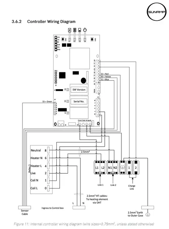

Also, one other concern that I have is the number of breakers necessary for installation. The SunAmp installation manual (page 24 onward) looks a bit complicated to me, especially this part:
SunAmp Wiring
But it seems to me like this battery is almost something that could just be plugged into a normal 240v outlet. In other words, I just need to have a 240v double 15amp breaker for each unit. Am I missing something here? Is there something that I need to be really careful with? I am going to have a qualified electrician do the installation, but I want to know as much as I can about this before making the order. It's coming from the UK and returning these is not much of an option.
