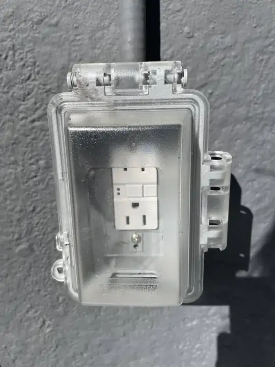

We had some rain that blew sideways yesterday and tripped our outdoor GFCI which is connected to our tankless gas water heater. The orange light is showing and we can’t reset the outlet. I’ve turned off the main breaker feed to the water heater to avoid any more damage. We are shivering in our showers and need a solution.
Model for water heater: Takagi AT-K5U-OS-N at AC 120v

    Based on the new photos - GFCI is almost certainly a code requirement because it's outdoors AND handles water. Since the unit is hardwired, I think it is a code requirement to have a disconnecting means within sight of the unit (similar to A/C units), which having the GFCI outlet outside right underneath would satisfy (you could press the TEST button to disconnect the electric to the water heater). GFCI outlets are often cheaper than GFCI breakers, and outdoor outlets are often useful, so the arrangement makes *some* sense. – maples Nov 11 '22 at 12:46
    Oof, looks like the bottom of the GFCI box is open, so the GFCI is open to the elements? Is that OK with US code? AFAIK it's not OK here (Europe, The Netherlands), and I personally wouldn't ever want it. I'd say get another one of those rubber stopper thingies you see on the side, but then for the bottom. Then that box should keep your GFCI nice and dry, no need to move it inside. – Daniël van den Berg Nov 11 '22 at 14:31
    @DaniëlvandenBerg: The WR rating on the GFCI indicates that it's supposed to be weather resistant, and in most places rain doesn't fall upward (winds may cause localized sufficient updrafts to propel rain into the bottom of enclosures in some places, but wouldn't expect that here). – supercat Nov 11 '22 at 20:34
    @DaniëlvandenBerg - The hole in the bottom is to allow the power cord that's plugged into the outlet to exit the box. Of course, in this case such an exit isn't needed. – Hot Licks Nov 11 '22 at 22:25
    @DaniëlvandenBerg I have a box exactly like it; there are plastic inserts that slot into the grooves around the opening to seal it. You're supposed to only remove them when the outlet is in use (to allow the cord to exit). My question would be whether the BACK of the box was sealed properly against the house. Idiot contractor I bought my house from put these on, but left gaps BEHIND the box. First hard rain blew the outlet. I replaced it and properly sealed it, has survived several hurricanes since. – Doktor J Nov 12 '22 at 20:10

Disconnect the load wires from the GFCI. Turn the breaker back on and try to reset the GFCI.
If it cannot be reset, the problem is in the GFCI. This is common for GFCIs mounted outdoors. You will need to replace the GFCI, and you should try to make it more weatherproof. It needs a good weatherproof cover (UL listed for that purpose) or better yet, relocate it indoors.
If the GFCI can be reset with the load disconnected, then you have a ground fault in the load (i.e. the water heater, the wiring to the water heater, or any other outlets that may be sharing that circuit).

Since you suspect moisture as the cause of the GFCI trip, use a hair dryer to evaporate the moisture in the GFCI box. After your hot shower, relocate the GFCI indoors.
Phil Freedenberg
  • 1,018
    In our house a circuit on a GFCI breaker tripped due to water getting into an outside box. I removed the box cover and dried out the box with hair dryer. The OP should remove the box cover (two sccrews) and direct the air in with a hair dryer, but be careful not to overheat the GFCI receptacle. Alternately, you could use a shop vac (or any vac) with suction and see if pulling in fresh air would allow the GFCI to reset. You might even try suction on the receptacle without removing the cover. Vac on one receptacle so air pulled in through the other. – Jim Stewart Nov 11 '22 at 16:31
