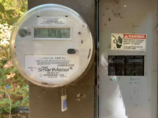

Our current setup is this pole with a meter with 50amp service. It currently provides power for a small barn and a well. (This is a secondary meter on site that previous owners had for their sheep rearing business.)

I bought this Siemens Meter-Load Center Combination, 12 Space, 6 Circuit (https://www.amazon.com/gp/product/B00L2HFH6C/ref=ppx_yo_dt_b_search_asin_title?ie=UTF8&psc=1) but there are not any lugs to send the SE cable out. It I guess just operates on the 'less than 6 switches' rule for NEC and has no main disconnect.

Your application is common (at least in North America): sprawling compound, service on a pole, and the desire to web power out to several outbuildings while also sending the whole kaboodle to the house. We have the perfect panel for that, it's called a ranch panel. Meter + main breaker + 8 breaker spaces + the thru-lugs to send 200A to the house. Here's one with meter pan and one without. These things are absolutely perfect for your application - it's what they're designed for.
However... whatever you use for a meter pan (integrated into the ranch panel, or separate) must be on the list of models approved by the power company. They are your first stop while shopping. If it's not on their list, the power company truck will drive away.

Please confirm this specific box was on a list from PGE or specifically approved by them in some way, preferably not just verbally. Each utility has particular meter panels that they approve. The lists change over time, and they may allow certain exceptions due to supply shortages. But if you get the wrong thing they won't connect your service.
Assuming that this is an approved box:
The breakers count as the disconnect. They are the first thing after the meter. Rule of 6 in general is not a great thing these days, but this box is specifically designed for that - instead of "12 space/12 circuit" (like a regular panel might be) or "12 space/24 circuit" (double-stuff everything) it is "12 space/6 circuit" - i.e., you only put 240V double-breakers in here, with a maximum of 6 throws, conveniently matching Rule of 6.
