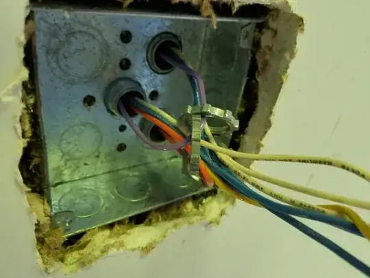

There are several previous questions that have been asked on this topic but they're all related to receptacles. I'm seeing that it is against code to use 14 AWG on a 20 amp circuit but when it comes to smart switches, manufacturers don't seem to follow this code.
Looking at 3 switches I have (Lutron, TP-Link, Insteon), none of them are 12 AWG. In fact, the Lutron is using 18 AWG wires. I enlarged the text in the picture to clearly see this.
My question is, how is it any different or worse to connect 14 AWG wires to a switch with the screw-in type fastener to then connect to the Romex? (bottom picture)
Essentially these are pigtails and are not soldered on like the other 3 switches.

    Those switches are tested to be safe using that gauge wire for that distance. If you spend the money to have a short piece of 14 gauge wire pigtailed onto a 20 amp circuit, you can do the same thing(The testing probably much more expensive than six inches of 12 gauge wire). – crip659 Nov 21 '22 at 22:31

No. They follow UL standards, which are what apply to equipment design, and take into account design considerations for equipment. Testing labs such as UL and ETL then certify their equipment as safe.
That is the end of your query, I'm afraid.
The UL rules require certain considerations such as pigtail wires less than X inches long, or internal component arrangements that might make overcurrent impossible, or other engineer-approved methods to assure a worst-case scenario won't cause a problem.
So, seeing a #18 wire on a UL/CSA/ETL Listed device inside a junction box, is not in any way the same as seeing a #18 wire inside a wall packed in insulation.
The UL standards work because they are subject to engineering supervision. I mean you can do anything you want with engineering supervision. Get a qualified engineer to sign off on it, and you're good to go. The problem is paying for the engineering supervision and nobody wants to do that. To make house building possible, they had to come up with construction rules that non-engineers could follow without requiring review by qualified design engineers. That's the point of the NEC. Simply follow the rules and you are assured of work which meets engineering standards.
Yes, it might be overkill sometimes, but consider the alternative.
    Can you provide more insight? If a #14 wire cut to the same length and is fastened to the switch then wrapped with electrical tape, how is that connection more dangerous than connecting a #18 to the same wire? Does the plastic enclosure provide extra protection from a possible spark? – jpQuick Nov 21 '22 at 22:51
    @jpQuick It is not necessary less safe, it is it has not been tested to be safe So instead of having people who do not know enough adding 14 or smaller gauge wires to a 20 amp circuit, they use a blanket big NO. You start with six inches of 14G, next you are wanting to add a few feet. – crip659 Nov 21 '22 at 23:12
    @jpQuick It's entirely possible that you could get UL engineers to look at your junction box and agree that it is safe that way. However that presumes that "engineering" is an unbounded and free resource, and if you think that, I'm guessing you don't work in recruiting for a tech company LOL. Absent infinite engineering resources, baseline rules must be set. Why should Olympic track runners need to follow lanes? Why can't they choose any arbitrary course so long as (with unlimited engineering resources) it can be proven their path is not shorter? – Harper - Reinstate Monica Nov 21 '22 at 23:36

It is not that the 14 AWG wire will zap you. Properly insulated (just the original insulation, no need for extra tape) will protect you from being zapped.
The concern is heat, because heat leads to fires. A 14 AWG will heat up more than a 12 AWG wire, and if that wire is inside insulation and at a full 1500W then it could be a problem.
But, you may say, I am only using it for 50W of LED lighting? That's true now.
But the next owner (we see it all the time) will ask about connecting a receptacle in the same box. But wait, they may say, I only want to use it for plugging in phone chargers (low wattage, minimal heat).
But the next owner will see the receptacle and decide to plug in a space heater when the furnace is on the blink. Oops, two space heaters because it is a duplex receptacle. That's 24A - 2 x 12A - because a standard US space heater, with or without a fan, ceramic, oil-filled, whatever, uses 12A = 1500W (based on 125V).
24A = 120% of 20A (the circuit breaker) but 160% of 15A (what you should have for 14 AWG wire).

Other answers here are correct. Considerable thought and testing and experience leads us to the knowledge that your switch with its #16 wire will not set your house on fire but if people use #16 wire on 15A circuits, some of them will set on fire. It's a set of principles that works when everyone adheres to them.
In this answer I'll illustrate just one possible reason these principles apply to your house. But this illustration is not the reason. The reason is pretty much what Harper said: One set of rules for people building switches, another set of rules for people wiring up houses.
The illustration:
  • Your switch is labeled "Max 600W load". That's 5A. #16 wire can handle 5A.
  • The switch might have a fuse or some other gizmo that prevents it from drawing more than 600W. Certainly, if you put 1800W of lighting on it something inside the switch will break before its wires or any other part of it overheat. That's why it got UL listing.
  • You wrote in your question that it's #18 wire. It's not. Which further illustrates that people like you are more likely to make mistakes than people designing switches for UL approval.
  • Now, what if it was ok for you to use #16 pigtails, and you use #18 because you think that's ok, and you sell the house and the next owner removes the switch, installs a receptacle on your pigtails and someone plugs in a 1500W space heater and goes to sleep?
