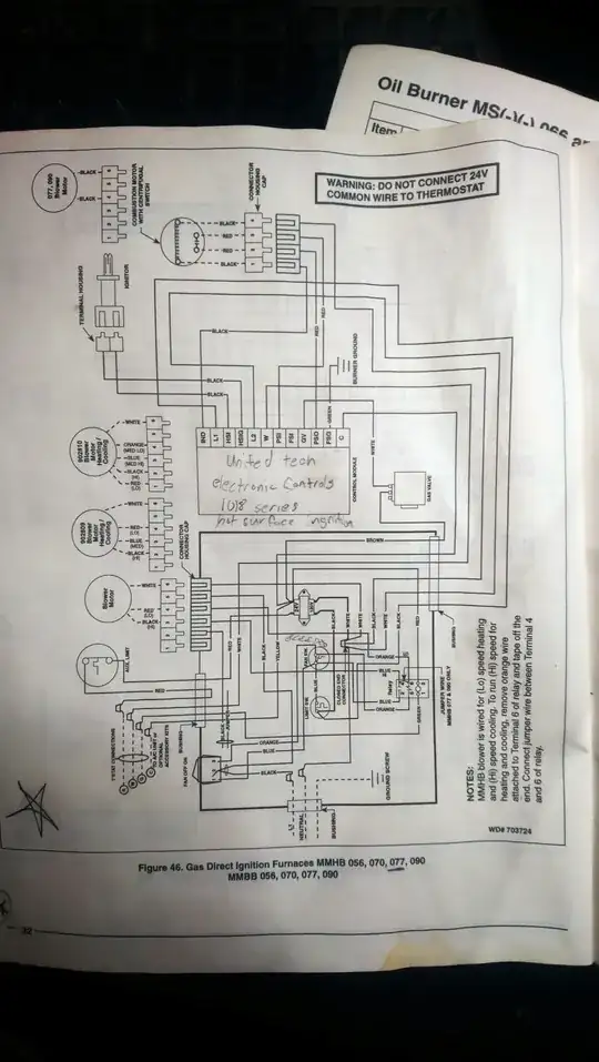

Schematic
Schematic

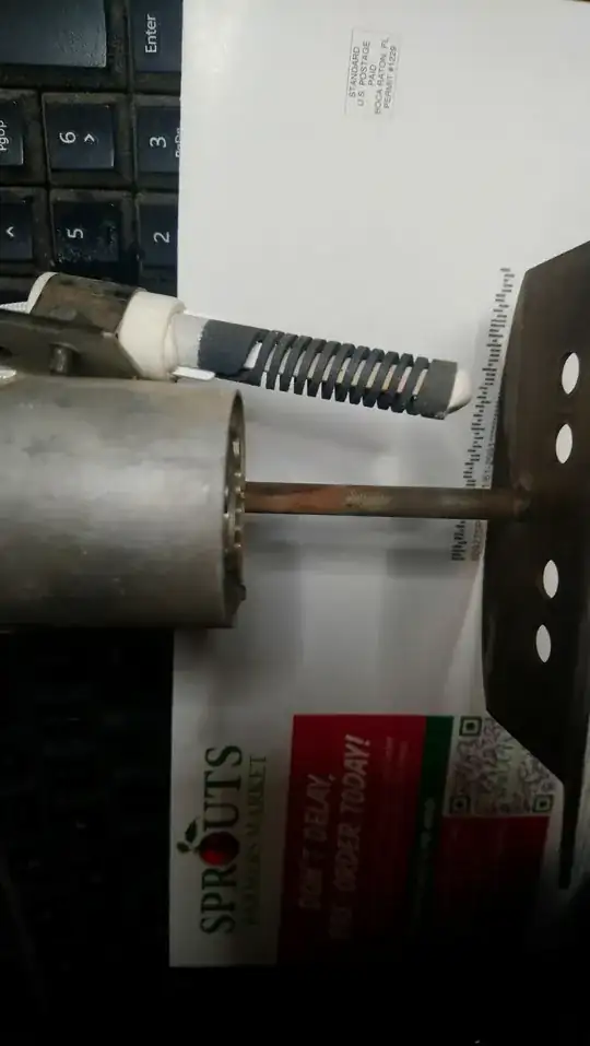

Igniter/flame sensor
this is a photo of the igniter. as mentioned below also operates as the flame sensor. It looks pretty clean, but I'll give it a light cleaning before reinstalling it. What should be the measurement for the 'flame sensor' when the igniter(mode) is not active and the flame is on? igniter

  • lets review the electric schematic find and post – asinine Nov 24 '22 at 03:12
  • Fan is working, the signal from thermostat turns it on, so the really is working – asinine Nov 24 '22 at 03:31
  • here is something for you to read https://www.ohthelovelythings.com/home-gear/nordyne-furnace-troubleshooting/ – asinine Nov 24 '22 at 03:37
  • Small possibility an issue with the furnace turning on the fan - Turn off the furnace, turn FAN to ON via the thermostat, turn on the furnace, fan should start right away - see if it goes through the ignition, etc. and whether it stays on or cycles. If it stays on then it may be an issue of the furnace not properly turning on the fan but with it already on everything works. If it does not stay on then sounds more like flame sensor or similar. – manassehkatz-Moving 2 Codidact Nov 24 '22 at 05:20
  • I added some more tests ive done and the schematic. I have no flame sensor. I think ive covered all your comments – Zef the Tinker Nov 24 '22 at 14:25

  • "none of the sensor/switches change state" - pressure sensor on the inducer blower should go from open to closed. If it isn't the flame sensor, then the next trip out is an unsatisfied exhaust. I've never known a furnace to trip a roll-out sensor. There isn't much else if the blower, the gas valve, and the igniter all work. On some furnaces the igniter is the flame sensor. Clean it with 3000 grit sand paper. – Mazura Nov 25 '22 at 05:32
  • A clean sensor or not, if the *flames burning heating sound was louder* and it's being intermittently starved for supply, then it's doing what it's supposed to. Any change to the (gas) stove's performance; any change in color? – Mazura Nov 25 '22 at 05:37
  • My unit doesn't have a pressure sensor, my gas stove looks normal flame height and color normal. Ive added an update to my status, see above. – Zef the Tinker Nov 26 '22 at 17:47
  • A hot surface igniter wasn't what I was expecting to see if it's also the FS. But w/e; [it *is* both](https://www.starsupplyusa.com/products/igniter-fm-903110): banging on the gas valve makes it work? Bad gas valve or under-powered transformer. - *"combustion motor with centrifugal switch"* : PSI and PSO closes when it runs, right? That's the signal from the inducer blower running. – Mazura Nov 26 '22 at 20:52

  • +1. "**The ignitor is also the flame sensor**." https://www.mobilehomerepair.com/phpbb/viewtopic.php?t=2693 @ZeftheTinker – Mazura Nov 25 '22 at 05:26
  • thanks, i attached a photo of the ignitor/flame sensor. It looks clean, but ill clean it a bit. what should be the measurement and value for a working flame sensor? – Zef the Tinker Nov 26 '22 at 16:40
