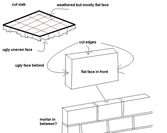

We're going to cut up and remove a slab. I figured I might as well (attempt to) cut it into rectangles and use it for landscaping. If I wanted to mortar them together like bricks, what should I use? Every time I search for guidance, I get instructions concerning "concrete masonry units" which I'd normally call "cinder blocks".
I'll have to look into the economics of feet of cut per cement saw blade, but if we make big enough blocks surely it's economical at some point.

    @Mazura I'm talking about a wall, specifically a retaining wall where the rough faces will be towards the earth and the gaps filled with gravel, not flat on the ground as pavers, with anchoring to keep it upright in the long term. I'm demolishing the slab regardless, so the cost of cutting the slab neatly is being compared against the cost of destroying the slab by cheaper means + paying to have the cement hauled away + turning around and buying a similar amount of new cement, possibly in block form. – gunfulker Nov 25 '22 at 06:37
    Ah, it's a wall. Ok, I'm onboard then. "If I wanted to mortar them together like bricks, what should I use?" Mortar. Except they're not bricks, they're 'stone'. *What type of bonding agent to use for recycled concrete blocks?* +1. My guess is Portland cement and expansion strips every 5'~10'; *not* mortar. – Mazura Nov 26 '22 at 01:08
    *Below Damp-proof Course* : sand and cement. No lime. [What type of mortar for foundation blockwork below ground level?](https://diy.stackexchange.com/questions/248987/what-type-of-mortar-for-foundation-blockwork-below-ground-level) The answer calls it M6. – Mazura Nov 26 '22 at 20:31
