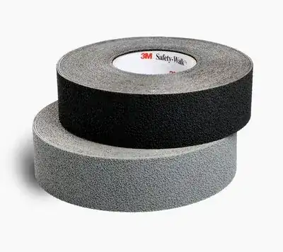

To expand on the grippy tread tape suggestion:
I live in Wisconsin and also see snow and ice. I wanted to make my mail carrier's life a little easier and safer and install some grip tape, having done so on my mom's back stairs, as she has mobility issues.
You can find these at your local hardware store. The Ace Hardware I went to had it in big rolls. You measured and cut off what you needed, wrote down the SKU and had it rung up at the register.
I got a 3M brand, like this:
Two rolls of grip tape, stacked on top of each other, grey on the bottom and black on the top.
Application is relatively simple. My stairs are wood, so I sanded them first. It sounds like yours are painted, so some primer or other roughing-up might help. Then, you pull a backing strip off and then apply the gluey side to your surface.
The hiccup I encountered, and would like to warn you about, is that this must be applied while the weather is still relatively warm, which is not when I think about ice prevention. The 3M tape I grabbed needs to be applied at above 50 degrees F/10 degrees C. This information is on the back of the tape, on the backing strip, so read carefully.
