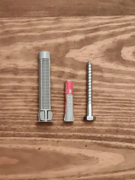

socket, plug and screw

Yes, you should be able to drill the resin/epoxy/plastic with a general purpose drill bit.
If you use a smaller drill bit you should be able to just drill screw-tip clearance beyond the plugs installed, rather than drilling them out and replacing them.
  • Thank you for your answer! Just to clarify, should I remove the inside plug and then drill enough resin so the screw can fit? Looks like there is no other option... since if I try to drill through the plug it will damage the plug itself... – a--m Nov 30 '22 at 12:42
    @a--m the plug is plastic. The steel of the drill bit and/or screw will crush/destroy it, so don't worry too much about the plug. You do, however, want to drill the smallest pilot hole necessary (the bit should be about the size of the solid shaft of the bolt, but smaller than the diameter of the threads. This will make clearance for the solid shaft, while leaving material for the threads to bite into so the bolt can hold in place. – FreeMan Nov 30 '22 at 13:25
