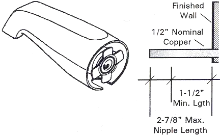

Spout connection types There are three main types of how a spout connects to the pipe
  • 1 Front threaded. The pipe traverses the length of the spout internally, ending in a threaded fitting (usually 1/2" IPS). A front threaded spout usually does not integrate a diverter.
  • 2 Rear threaded. The pipe connection is made at the rear of the spout. These spouts can be either diverters or tub only.
  • 3 Slip on. These spouts will work with just a clean, open copper pipe, as it has a set screw adapter to clamp the pipe.
Slip on tub spout

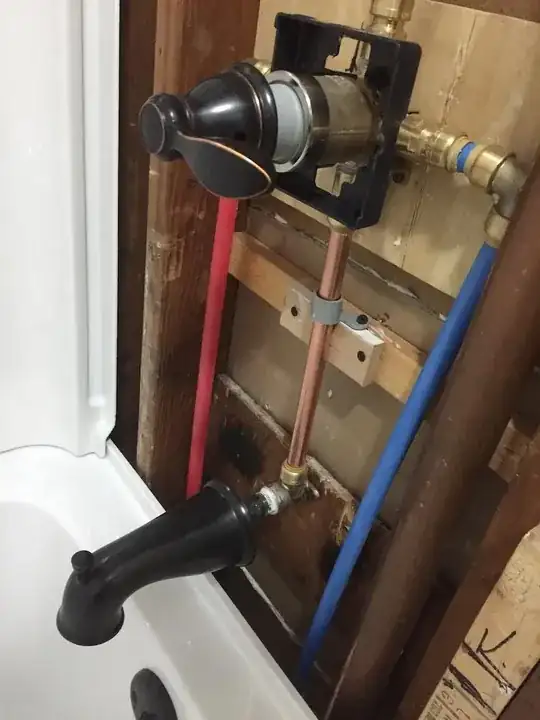

Here's a bathtub spout install with sharkbite. Run a length of 1/2 copper pipe as needed from bottom outlet of mixer (use 1/2” female sharkbite adapter) to about 4 inches above rim of bathtub. At bottom end of cooper pipe install a 1/2” sharkbite shower adapter upside down. Get a 1/2” steel pipe threaded at both ends from any hardware store. Screw one end into the spout until tight then screw the other end protruding from spout into the shower adapter. Use “tuff” at both ends to avoid leaks. I use a 6” steel pipe. That’s it. Works fine. (I’m not a plumber >>> DIY)
Tub and shower install using PEX
