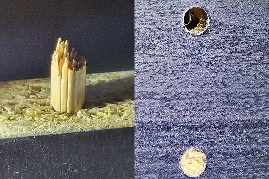

IKEA furniture often has wooden dowels that are used to hold pieces together. The problem is that these wooden dowels break easily when you're trying to disassemble IKEA furniture:
Enter image description here
In the first picture I could just use pliers to pull the broken dowel out, but what for the second picture? I got a screwdriver for a watch screw and tried to use a hammer to try to get it sufficiently far in there such that I could kind of lever it it, but that did not help.
So what are my options for the second picture?
And what can I do to prevent this from being an issue on future IKEA purchases? If the dowels were metal they'd probably be a lot harder to break, but alas, I have been unable to find metal dowels. Plus, I gather that the dowels can come in different sizes...

There are several techniques.
  1. Locking pliers gripped to the dowel (perpendicular) and hammer on the locking pliers to pull the dowel out of the material.
  2. pre-drill the dowel slightly smaller than the diameter of a #8 screw, screw into the broken dowel and then use technique 1.
  3. sometimes the dowels are actually glued, in that case you can cut flush and then use a drill and drill bit to drill out the portion of the dowel still in the hole, generally you take a replacement dowel and find 1/2 the length and mark that on your drill bit so you don't over drill. a drill guide can also be used to keep the drill bit centered on the hole. Generally I just get a piece of scrap wood that is at least 1/2" thick and then clamp or hole it such that the hole lines up with the cut off dowel. The guide will help you keep your drill plumb with the hole as you drill out the left over dowel.

    Yah - it's unclear to me what "vice grips & hammer" is referring to. Do you hammer in a nail and then use a vice grip to pull the nail out? – neubert Dec 06 '22 at 13:45
    @neubert I would clamp the vice grips around the unbroken part of the dowel and then use the hammer to strike the vice grips near where it clamps to the dowel. You can (carefully) twist the vice grips, too, but this may lead to the dowel breaking further. – user2259438 Dec 06 '22 at 14:51

I would probably try, a little bit, to get the dowels out. But if they break, cut them off with the saw of your choice (hacksaw, reciprocating saw, etc.) That may leave 1/2 a dowel in a hole, but that's OK because these dowels are not critical in and of themselves.
If you really want to get them out, you can use a drill. But be careful because a lot of times the dowels are in holes that only go partway through a piece of wood and have a finished surface on the other side. Better to leave them in there (but chopped off so they don't get in the way) than to take them out and mess up everything else in the process.

Screws to remove the dowels
For your second picture, put a small screw partway into the dowel, then use any suitable tool (claw hammer, prybar) to lever it out. Failing that,
Drill out the dowels
Get a drill bit slightly smaller than the hole (you don't want to damage the sides) and drill out the broken dowel. Nice and easy, just a little more messy than the first option.

I've bought a large number of used Kallax and Expedit shelves and encountered this problem more times than I care to remember.
Step 1:
Obviously if there is enough dowel sticking out a pair of pliers will get it right out. Don't use clamping pliers, you are likely to shatter the dowel.
If that fails:
Step 2:
Some have suggested drilling and screw pull, but i found if I used a smallish phillips wood screw I could skip the whole drill step.
Screw in a half dozen threads.
Step 3:
Claw hammer that b**** out of there.
This has never failed for me. Good luck.

Screwing a screw into a dowel may cause it to expand and stick in the hole. You can minimise this by drilling a pilot hole that's similar to the core diameter of the screw (self-tapping screws typically have a straight core while woodscrews are typically tapered). Drilling the entire dowel out is possible but needs to be done accurately. If all else fails, another option would be to drill a small hole and glue in a piece of wire using epoxy resin, then pull out the entire thing once it's set.
