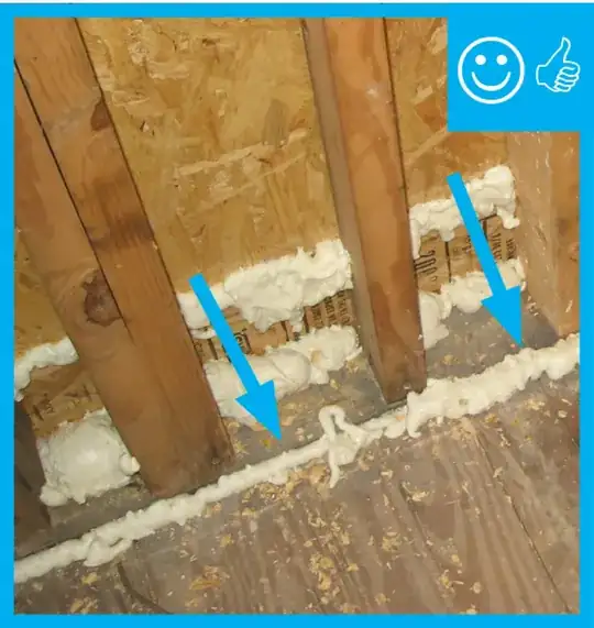

  • I went with a small bead of spray foam. One of the “good” images from this guide showed spray foam along that joint. https://basc.pnnl.gov/resource-guides/air-sealing-sill-plates – Josh Bush Dec 08 '22 at 14:27

I went with a small bead of spray foam. One of the “good” images from PNNL's guide (reproduced below) showed spray foam along that joint.
image of spray foamed sill plate
