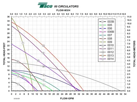

Armstrong S25: 1750RPM; 1/12HP; 9-32 Flow-GPM (original system circ, was ideal setup)
TACO 007: 3250RPM; 1/25HP; 10-24 Flow-GPM (problem: few pops after boiler startup)
TACO 0010: 3250RPM; 1/8HP; 10-33 Flow-GPM (problem: water flow sound + wailing when boiler heats up)

  • Where is the expansion tank located relative to the pump intake/output? I expect you are hearing cavitation, which is *not good.* Frequently the expansion tank is in the wrong place relative to the pump, which aggravates this. Unless you have a particularly low set safety valve, might try increasing system pressure from 12 cold to 15-20 cold, which *might* be enough to stop that, while not tripping a typical 30 PSI pressure relief safety valve when hot. put **sound of pump cavitation** into a search engine for examples. – Ecnerwal Dec 10 '22 at 15:24

The Taco 0010 is not the closest match for the Armstrong S25. The S25 is 8 foot head at no flow and 32GPM free delivery. Those match up with a Taco 008 circulator.
The Taco 0010 is 14’ shutoff head and 56 GPM free delivery. It’s pushing much more water through the pipes, which as you noticed can be noisy.
That said, I suspect you’re hearing air gurgle around because you need to purge the air from the system.
