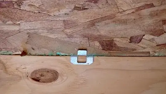

The panel edges are tied with H-clips, or you can stick in 2x4 blocking at the top of the framing if you really want to screw them down.
H-clip picture from nachi.org
H-clips are considered to be equal to or better than blocking for edge support. Better than because they ensure proper panel spacing. They also cost less in time and money than installing blocking to screw to. Images from nachi.org
