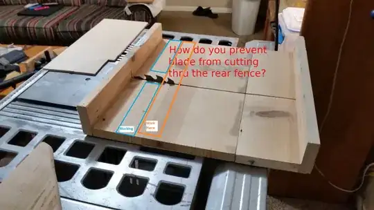

How do I prevent the blade from cutting into the "fence" of my table sled?
Wood rails engage slots in the table saw.
I see no way of raising the sled by much.

    Is your concern safety, or the blade cutting the fence apart? For the former, it's fairly common to build a box at the back of the sled into which the blade can travel without being exposed, thus keeping hands away from spinning metal unless you cut all the way through the box as well. For the latter, make the fence tall enough that it won't be cut through at the highest blade setting you intend to use (with some amount of space above that height to preserve strength). – keshlam Dec 12 '22 at 21:24

This is supposed to happen
Sleds are partially sacrificial. That's the whole reason they're made out of softwood and not steel.
What to do about it depends on what you're trying to accomplish.
If you're worried about the sled breaking, especially what with that knot there, then go ahead and sister it with taller timber such as a 2x8 set alongside the 2x4 (not stacked with it). Although you could just double it with a 2x4 that doesn't have a knot right there. I myself would glue and screw, but you do you.
If you're worried about the blade coming out beyond the sled and biting a careless thumb, I would seriously work on my body-awareness and sense of craft (or get a SawStop)... but OK then. In that case, add some timber to create a bunch of empty space between the active surface (the other side of this pictured 2x4) and the place the saw will actually be going.
Maybe a V-shaped guard cut out of 2x4 and topped with a piece of plywood. Or simply sister the visible 2x4 with a couple more 2x4's on the inside, although this would narrow the width of the sled.
    +1 Absolutely supposed to happen. 20 years' experience in a cabinet shop, I made and used sleds like these many times on table saws for cross-cuts, when a chop saw wasn't the correct way. A tall-enough back edge prevents trouble from the blade going though it. – Triplefault Dec 13 '22 at 00:21

Well, that depends on whether or not you need to cut through your entire work piece.
All sleds that I've seen have the slit in the front and back. If you find that your sled is buckling then reinforce the fence by making it taller or screw on a metal angle bracket.

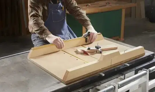

Option 1
Clamp your workpiece forward like this:
enter image description here Source

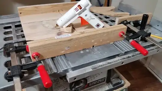

A work in progress, but I am happy with the results.

  • The rear fence was not strong enough. @MonkeyZeus – fixit7 Dec 14 '22 at 13:11
  • I see. You should consider marking [Harper's answer](https://diy.stackexchange.com/a/262374/42053) as correct and leave a comment indicating which part of their answer solved the issue since he was able guess the answer to the misleading question with `If you're worried about the sled breaking, especially what with that knot there, then go ahead and sister it with taller timber such as a 2x8 set alongside the 2x4 (not stacked with it). Although you could just double it with a 2x4 that doesn't have a knot right there. I myself would glue and screw, but you do you.` – MonkeyZeus Dec 14 '22 at 13:59
