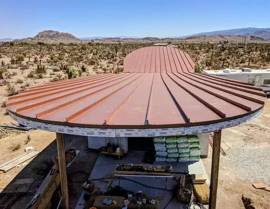

I've noted lots of wind noise from our standing seam panels, a roaring in the metal 'pans' forming the long panels that is, at times, deafening. My question: is there a reasonably effective solution?
Clips hold the panels 3/8" proud of the deck, for thermal reasons, but this gaps allows the 'pans' to chatter against the deck as shown in these short video clips taken 28 March 2022 during a wind and rain storm. If you watch the panels closely in these clips you can see them deflect with a 'pop' as the wind crests. I shot close to the panel axis to accentuate visibility of the panel cupping, which the rain also helps with.
Specifically, how can we shim the standing seam pans from below when the roof is installed? Below I show a commercial solution that stabilizes the panel pans with a network of purlins mounted above the metal panels, but it's a complex and rather expensive proposition.
Purlins mounted above are at least possible to access, since before I started hearing the wind 'roar', I counter-flashed the whole roof perimeter in metal and a weather barrier. That is, the area under the metal panels is sealed for waterproofing, as seen in these side and end views:

I'm looking for ideas that won't require that level of intrusion, or require penetrations in the metal panels to insert shims as the latter would defeat the whole point of a waterproof metal roof.
The roof is composed of the following layers: ply, roofing paper, insulation, ply, thermal barrier, standing seam metal, as shown in the photo below:

  • @FreshCodemonger, you can see the metal panel terminations in my separate post here: https://diy.stackexchange.com/questions/262373/end-caps-for-standing-seam-metal-roof. There is in fact a 3/8" air gap under the panels that I have added to my question; clips hold the panels proud of the surface for thermal reasons, but allow the 'pans' to chatter against the deck. – Kevin Cain Dec 14 '22 at 02:11
  • @RetiredATC, I added photos above that show the roof constituents in cross-section – Kevin Cain Dec 14 '22 at 02:17

  • Yes, @FreshCodemonger, the air gaps are continuous 16", 3/8" tall running 50'+ on either side of the roof valley. There's no access without cutting into the roof, which seems an awful idea since it would seriously compromise the waterproofing. – Kevin Cain Dec 16 '22 at 06:09

  • @FreshCodemonger, I like your idea. As you might imagine, I flashed (and counter-flashed) the perimeter with metal and a weather barrier, for waterproofing. I've added a photo showing this; the result is there's no way to slide members into place. I suppose the only option is to penetrate the roof to insert stand-offs at regular intervals, but that seems like a terrible thing to do to a metal roof. – Kevin Cain Dec 17 '22 at 18:12
