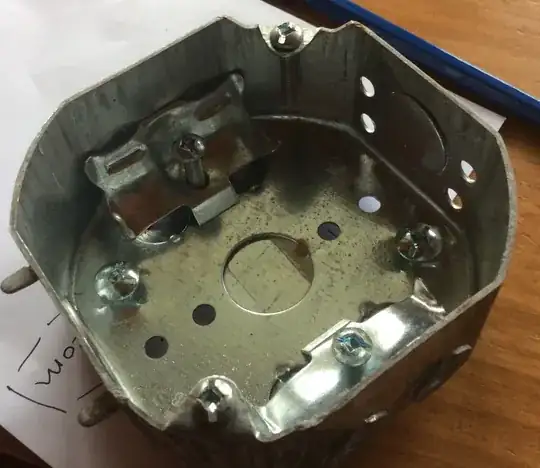

Somewhere in the back of the box should be a hole tapped #10-32 for a ground screw a lot like that one. Route the ground wire so it makes a "U" around that screw before it comes out to attach to the light.

Because that's not the correct box type for a light. It's for switches and receptacles. A light box looks like this
(except with appropriate mounting flanges for your requirements).
That's why nothing seems to fit. You can see where the diagonal screws create an important role for that adapter plate :)
