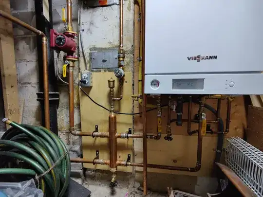

We have a five year old Viessman Vitodens 100-W. We have noticed that this year the temperature of the hot water is not behaving as it consistently did before. There is an issue especially with the shower/bathtub that when you open the tap fully, the temperature doesn't get as hot. If you only open the tap halfway, the temperature does behave as it used to.
The pressure on the boiler is down to the low green end of the scale.
I've been looking at how I can increase the pressure in the unit but our setup does not match any of the other videos/articles that I have found. I would love to avoid having to call in a technician if I can help it.

The low pressure at the pressure gauge should be a pure coincidence, since this shows the pressure of the closed heating water loop. Possible reasons are a defect breather (= the small brass cylinder in the middle of the photos) or a tiny leakage or a defect expansion vessel.
Topping up with water to increase the pressure: Sometimes special water is needed according to the system's documentation (demineralized water, anti-corrosion additives etc.).
The pressure should be checked at roughly same heating water temperatures. If the pressure drops again after a few weeks, the system needs to be checked beginning with the mentioned possible causes.
