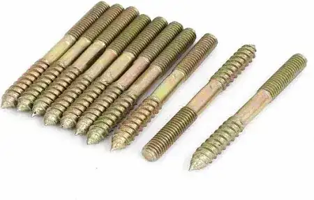

This is a fairly common setup. The bolt is usually a double threaded one with a wood screw at one end and a machine bolt at the other end.
One such example is here (ad from google / walmart) enter image description here
https://encrypted-tbn3.gstatic.com/shopping?q=tbn:ANd9GcRVzHQbA7fuS73a54vwPGySmSd6oYYTCXk8kYL3qFsrbvAjFi1KNhIC0kngc8QLlLVGUDCTlbbEA3j-iWnIzY7KkU19rRISNKmTWaZRmmGc6YBmxobJd47L
These are designed to bite into the wood and hold that end of the leg so that you can tighten it with the machine screw.
However, if your chairs are wobbling, it is often because this screw isn't tight or it has compressed the wood and made the hole bigger. So you can remove the dowel and pack the hole with sawdust, matches, and epoxy and re-install the dowel (pro tip: the center piece can be turned by a wrench).
Your second picture suggests that you might actually have broken the end of the wood screw off in the chair leg, and you'll have to drill it out.
Apart from that, in addition to using a wrench, you can use a long socket. However, overtightening the machine screw just tends to bend the quarter wooden piece forcing the rails apart.
