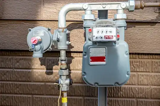

Who should I contact to replace the gas governor?
Is it upstream or downstream of the gas meter? It is normally upstream (between the shutoff valve and the gas meter).
Preferably, place the regulator on the intake manifold and the gas shut off valve on the gas supply pipe.
Source: Can a Gas Regulator Be Installed Vertically? - Norgas Controls
A gas service regulator is connected to the end of the service pipe before the gas meter to reduce the gas pressure to supply gas appliances installed in the premises.
(emphasis mine)
