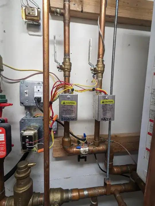

  • Can you edit to add a picture of the controller itself and the inside of one of the zone valves? – Chris O Jan 05 '23 at 18:22
  • Should be updated now – Havegooda Jan 05 '23 at 18:27
  • Edited my answer to reflect the new information – Chris O Jan 05 '23 at 18:35

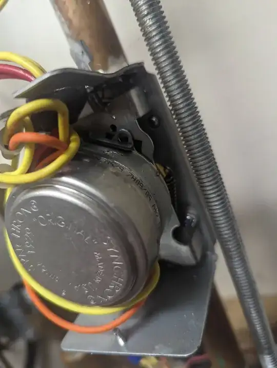

Edit: Thanks for adding the pictures of the zone valves. I notice that there is what appears to be a fuse in the bottom corner with a rating of 125/250V which means that your zone valves could be line volt even though I suspect they are 24V. That just means be careful around them (although you already should be with any power, of course).
Those syncho motors should be audible when the open and close. Try powering the system off and on and see if you can hear one or both of those valves working.
Controls
Thanks for also adding a pic of the controls. I see that there is really only one signal wire (yellow) which suggests that the decision for which zone to open is being made at the thermostats themselves and the control board is just responsible for a general call for heating. If the zone valves are not working, I suggest looking at the thermostats themselves to verify they are working properly.

  • OK - we've verified that your pump is probably OK then. I'm looking at the zone valves now. Can you open one of them up and edit your question with a picture of what's under the cover? I want to make sure that the zone valves are working. – Chris O Jan 05 '23 at 18:15
  • Updated to add pictures, tried to get all angles – Havegooda Jan 05 '23 at 18:23
