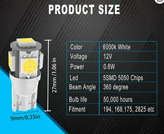

As @RMDman suggested, those are lower voltage bulbs. A type 194 bulb designed for automotive 12V DC systems looks like this:
and a modern LED version may look more like this:
With LED versions, many send light out the end in a cone rather than radiating in all directions. The pictured LED version has emitters for all directions, but may be too bright for your application. It may be easier and give more uniform light just to go with an old-school "long life" bulb. Such bulbs should also work with lower-than-spec voltage unlike LED bulbs.
Before choosing a replacement bulb, use a multimeter to determine the voltage supplied across the white wires to your bulb mount, and whether it is AC or DC. Your fixture looks like it has the bulbs in series, so each bulb would get 1/2 the voltage measured between the two white supply wires. As others have noted, LED bulbs may have polarity issues if it's DC, and may not work right on AC.

    Automotive bulbs definitely run on DC. Low voltage light domestic fittings might, but are more likely to run on AC. Many but not all car-type LED bulbs have internal diodes to run on either polarity (as the sockets aren't well-controlled). Incandescent (filament) bulbs don't care whether they're on AC or DC. You may find an LED bulb works at reduced power, and it might not last as long as expected. – Chris H Jan 09 '23 at 09:48
  • Most likely a 12v 194 but the advice to check voltage makes this the best answer. I believe it's a T-5 socket and many different bulbs are made to fit that base as can be seen in the "Fitment" cell of the photo in your answer. – Platinum Goose Jan 09 '23 at 13:59
