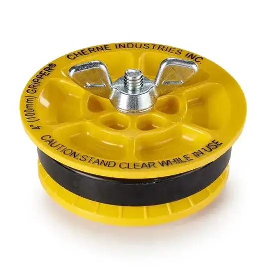

Oatey makes a number of "Gripper" plugs for many sizes of pipe and fittings. I have seen them available in big-box stores. There is a gasket and a screw you turn to tighten the plug into the end of the pipe/fitting, it is air/pressure tight (to a point) and it can be easily removed later.
They look like this: enter image description here

    No fear of deforming the pipe? – Steve Wellens Jan 09 '23 at 16:05
    I guess it depends how hard you crank down on the screw, but in my experience with them I haven't had any deformation. – SpikedCola Jan 09 '23 at 16:19
  • I had seen these (and am using one to plug the toilet drain, as I don't need to remove the flange to use it), but they are (considerably) more expensive than a simple PVC cap – mmathis Jan 09 '23 at 16:58
  • These are *also* used for plugging pipes when doing leak tests for inspections, so it may be worthwhile to have a couple of them, at least if you plan on doing any extensive work that you care about checking that it doesn't leak. – Wayne Werner Jan 12 '23 at 00:42
