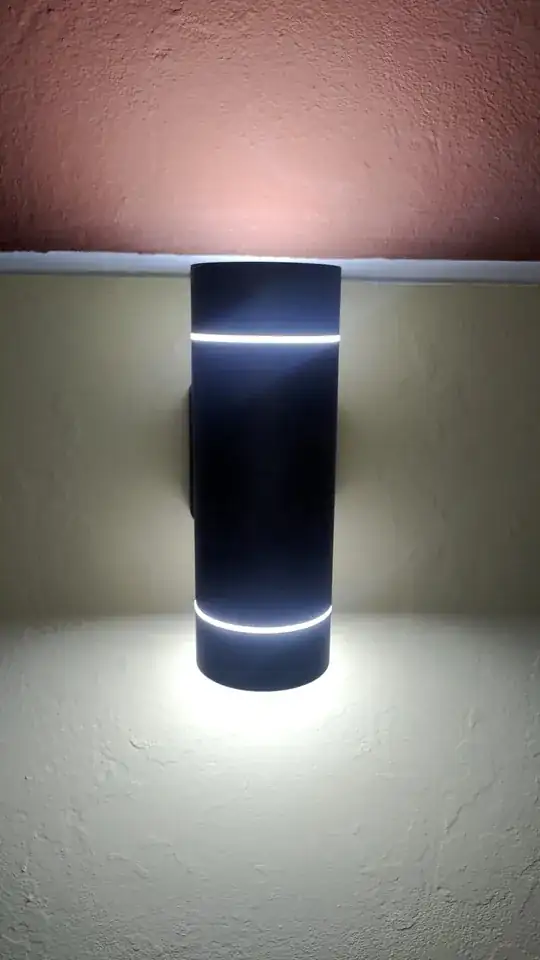

Put some 10-24 3 inch stainless steel machine screws with some washers and nuts on the outlet box to secure the light fixture wall plate. I put some concrete in the hole and put some screws with some wire on the end of the outlet box to give it something for the concrete to hold on and strengthen it a bit. Painted around the hole.
Test fitted everything and made sure that the round plate was level.
Not a traditional fix, but seems sturdy enough and worked well.
