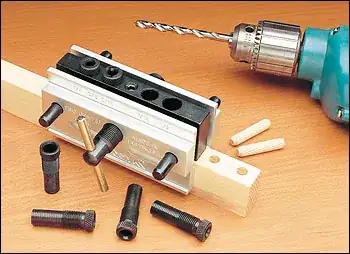

Buy a self centering dowel drilling jig. Lee Valley has them, as will virtually all wood working supply sources, Rockler, for example.
The jig clamps to the end of your board, and then you drill through a hardened drill guide into the board, using a hand drill. These dowel jigs used to be much more common in the days before biscuits, pocket screws, etc.
  • This looks like the very thing we need. Just got to find one in the UK :) – ChrisF Nov 07 '10 at 11:25
    Found an tutorial on using one of these which shows the exact thing we want to do - http://www.onlinetoolreviews.com/reviews/dowelmax.htm – ChrisF Nov 07 '10 at 11:34
  • Went with this - http://www.joint-genie.com/ - in the end. It was a little bit cheaper and is UK based. – ChrisF Dec 08 '10 at 00:21
  • I'll add that when I used a jig like that to bore dowel holes in some 1x2s I made up a wood jig to hold the wood straight and properly centered relative to the dowel jig. It only took 10 or 15 minutes to put it together, using a scrap of plywood for a base and several pieces of scrap wood. – Hot Licks May 08 '20 at 18:16
