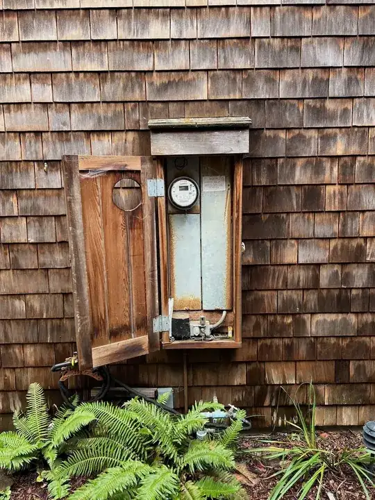

#1 - This is where service enters the property - at the garage outdoor meter box. This is just a meter box with cutoff switch. Service enters property at garage meter
#2 - 200 amp panel inside garage, just behind the meter box outside. Garage panel inside garage
#3 - Meter for the house. House meter
#4 - 200 amp panel for the house. House panel

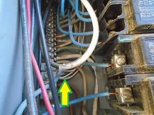

    Wait, aren't those nice colourful breakers the [infamous GTE Sylvania a.k.a Zinsco firestarters](https://inspectapedia.com/electric/Zinsco_Panel_Warnings.php)? Someone more knowledgeable will hopefully confirm, but I suspect you really want to replace that whole panel anyway. And those black breakers at the bottom look very out of place in that panel, perhaps they aren't even compatible. – TooTea Jan 19 '23 at 19:56

The Zinsco panel on the house has to go!
That thing is a fire hazard due to an inherently defective bus design. It cannot be "fixed" with new breakers. (similar to Stab-Lok). Part of your plan needs to be to replace that panel with a new panel. That will segue nicely into your plan to feed the house from the garage.
Also note, when building enclosures like that: Panels require a working space of the width of the equipment but at least 30 inches, 6'6" tall, 36" deep (stand-back distance), and kept clear at all times. The shrub needs to go. The enclosure is a problem because it sticks out too much compared to the front of the panel. Really it's allowed 0" beyond the surface of the panel, but most inspectors will cut you slack on just the thickness of the door. In this case that would mean an oval opening for the meter head (less if you hinged it on the other side). Alternately, you can make the enclosure large enough to fully enclose the working space - its top over 6'6" from the ground, and >30" wide. Then with the door(s) open, the working space is inside the enclosure.
Narrow service equipment like this is no longer made. Fortunately, you don't need a meter head here, and most panels are <14.5" wide. (to fit in a stud bay).

  • That's a Zinsco not a Stab-Lok, but yeah, it's gotta go – ThreePhaseEel Jan 21 '23 at 16:10

*I see a Sylvania sticker (not well stuck, though), but that house panel reminds me too much of "Stablok set-your-house-on-fire" panels - someone that knows those better can identify - if so, you want to replace before it manages the burn your house down trick.
