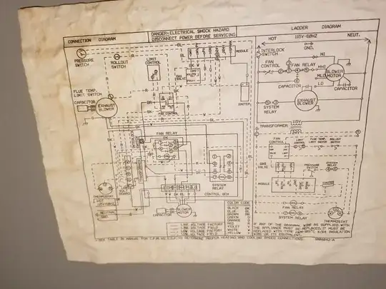

  • Can you post photos of the wiring diagram of the furnace please? – ThreePhaseEel Jan 21 '23 at 15:38
  • ThreePhaseEel Thanks for your help. I added a photo of the wiring diagram. The Furnace is a Heil 7000 Mode # NUGK100DH08 867.769437. Any help would be most appreciated. Thanks. – RGM Jan 22 '23 at 20:37

your short cycling is being caused by an overheat of the furnace. you just replaced the thermostat and the old one was battery operated. The battery operated thermostat is not able to be turned off like the hardwired one is. So you never experienced an issue until you replaced the thermostat. The thermostat is not at fault. Your furnace is trying to protect itself. Pull your furnace filter out and see if that solves the issue, if it doesn't then make sure all of your registers are fully open and check around the furnace for possible dampers that have been installed into the ducts. If you find dampers make sure they are fully open.
If you are still having an issue I will need the model number and manufacturer of your furnace. I will also need to know the size and number of registers in the house and also the size and number of returns in the house.
Your exact problem happened to me and it ended up being that the furnace was too large for the size of the ducts in the house. Need to do the number crunching in order to figure that out. Also when I said that I need to know the size of the registers I am referring to the size of the pipe going to the register and not the physical register itself. You will have to take the cover off to measure the size of the pipe.
Another way you can induce more airflow is to take the cover off the furnace where the blow is, If there is a switch that shuts the furnace off when you take the cover off you will have to jumper across the 2 wires connected to it to keep the furnace on. If you still have short cycling that is occurring you can test the wiring coming out of the transformer. You will find that it still has 24VAC. If it has that then it is a confirmation that the furnace is overheating. The things that are powered by that transformer do not pull a lot of amperage and the transformers when they go bad they short out or stop working all together. If you pull too much current from it it is going to melt the windings in the transformer or it will blow a fuse in the furnace. I have never seen one cut in and out from too much current.
You can see the circuit I am talking about in the wiring diagram you posted. I zoomed in to the area in the attached photo.
