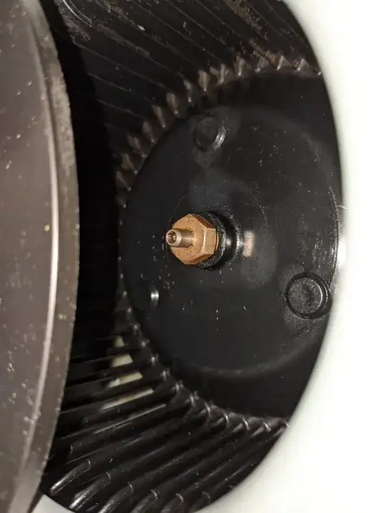

Here is a picture of what I intend to use:
Enter image description here
I believe (and could be wrong about this) that over time as the structure is moved, the nut that was fastened to hold the structure together will gradually loosen. Is there way to make the nut so tight and fixed that it will never become loose automatically, but only when the user needs to open it?

    Clarify please; do you plan on the fastener being easily removed regularly with hand tools? Or is it acceptable to make it permanent and require destructive removal ? – Criggie Jan 22 '23 at 11:50
    If we knew what the structure was, and was made of, we may well come up with better fixings than nuts/bolts. – Tim Jan 22 '23 at 15:34
    Note, the OP's use case is [here](https://woodworking.stackexchange.com/questions/14382). Also, it's highly unlikely that anything more than a pair of washers and a good, firm _snug_ on the wrenches is necessary to keep this particular assembly "tight enough". Unless you're moving the desk on a regular basis, that's all you're going to need. This won't just fall apart on its own - there are no inherent vibrations as there might be for bolts on a car. – FreeMan Jan 23 '23 at 16:22
  • OK, the bolt will keep together two panels of chipwood, where one is put on top of the other and bolted togeher. Then the panels are connect vertically in a desk so their face is facing wall. When can bolts loose overtime, I am not sure. – quantum231 Jan 23 '23 at 22:51
