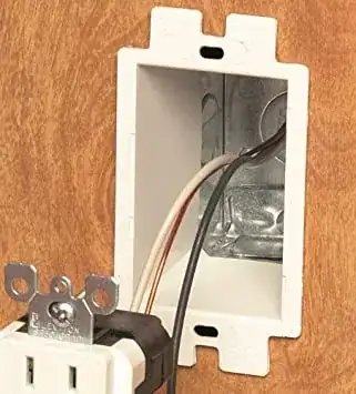

Regarding the outlet behind the shoe rack, if "It would technically be accessible" means that the local authorities would not require you to move it, then leave it where it is. If the shoe rack is a cabinet, the outlet can be brought through the back of the cabinet into the cabinet interior, using a box extender, like this:
box extender for through-cabinet-back outlets
https://www.amazon.com/Arlington-BE1-5-Electrical-Outlet-Extender/dp/B00303FYHS
Check the local authority for requirements for using these things.

    You should just be able to put a hole in the back of the shoe rack that's slightly bigger than the cover plate, @Joe. That'll give you the access "without tools" (presuming you can get to that part of the shoe rack without further disassembly). – FreeMan Jan 24 '23 at 19:49
