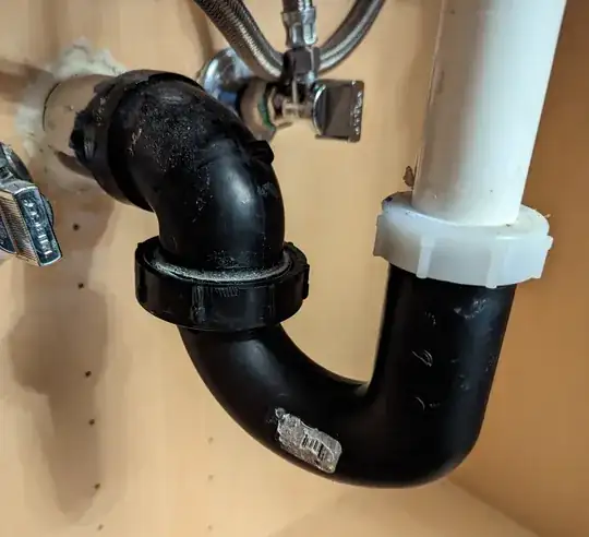

I have this P-trap that I thought was standard. I bought a transparent replacement described as "Fits 1-1/2 in. or 1-1/4 in. ABS" but the fitting (reducing gasket) was too small. So I'm guessing that this is a non-standard size. In my searches I haven't been able to find a larger size that's transparent.

I believe that I might have a siphon problem. In order to narrow down the problem I want to replace that P-trap with a transparent one so that I can see what's happening.
Looking for a solution that would help me get a transparent P-trap fitted onto this non-standard size coupling or some other solution that would help me understand if I have a siphon or other problem.
Problem is that it smells like sewer gas is coming back in. I've already removed and cleaned out this P-trap and replaced it once before but it doesn't make a difference and the P-trap was pretty clean and non-smelly itself.

    Either clean out the clogged vent, or add a Studor (AAV, Mechanical vent) if this thing is set up without a vent (should be going up from where the sanitary tee enters the wall) Fooling around with a clear trap is a waste of time, as you clearly have a venting issue due to the smells you report. >99% of the time it's a clogged vent, <1% of the time the inspector who passed the work should be vilified for not doing their job. Or the work was never inspected (*that* might be more than 1%...) – Ecnerwal Jan 27 '23 at 02:10
  • If your P-trap is glued at the back, then it will have only one kind of adjustment--it can swing in an arc. This is not really ideal because it is hard to line up with the vertical tube (called the tail piece) draining the sink. When it is glued like this it must be very carefully fitted before it is glued or it will leak. You really want a slip joint at the back allowing in-and-out translation, and rotation about that axis. This gives three different types of adjustment to get perfect alignment. – Jim Stewart Jan 27 '23 at 07:58
  • Your P-trap is not "standard", it has a union joint instead of the usual ones used with tubular drain fittings. I'm guessing the threads are 2" IPS. I would recomment cutting it out and glueing a trap adapter to the pipe emerging from the wall. In my experience, plastic union joints, unless they are the sort that uses a rubber seal, are nothing but trouble. – kreemoweet Jan 27 '23 at 19:07
Your likely problem is indeed improper venting.
You ask about ways to diagnose and confirm the problem.
When you have a foul smell, drain the P trap and measure the amount of waste water removed. You can catch it in a small container to see how much was in the trap.
If you don't like opening the unions of the one you have (it can be tricky and stiff at times), a transparent P trap would work of course, but also a "P Trap with Cleanout", a.k.a. a "P Trap with Drain Plug".
Image: Rona / Ipex.
If you have replaced the trap with the capped one, pour the water you drain from the new one in the old P trap to give you a quick idea of whether the trap is open or closed.
An AAV (Air Admittance Valve, a.k.a. cheater valve) under the sink will help, but you need to check your plumbing to determine the root cause. Your current dry vent may be clogged, and it may not be properly venting several other drains as well.
An AAV is not a substitute for circumventing a clogged vent.
They are allowed to assist venting a branch of your drain, but cannot be used in lieu of venting to the exterior. Any back pressure or methane build-up from the sewage will not be able to vent away through an AAV, and dangerous sewer gases can push through the P trap with sufficient pressure. Vents avoid this by relieving the back pressure.
Your vent stacks are likely visible on the roof, and you should inspect them to see if anything is stuck, like a pine cone, a clog of leaves or a rodent.

  • Seems like you could perform the "drain the P trap and measure the amount of waste water" portion of your test without buying a specialized part, by simply removing the normal trap (with a bucket underneath to catch any spills). – Tim Sparkles Jan 27 '23 at 19:31

    @TimSparkles yes. I just find removing the cap a lot easier. OP doesn't have to replace anything, but I assumed what was there was not suitable for the diagnostic task. I'll edit to clarify. – P2000 Jan 27 '23 at 21:55

  • As pointed out I'm fairly certain that you're correct that this is a blocked vent on the roof. When I went up there there appear to be 3 vents coming out of the roof and there are 2 sinks, a toilet and a shower below. This question now becomes "what equipment can I use in a 15' pipe to discover if it's blocked? And how do I know if I hit a blockage or the bottom of the pipe?" – Guy Apr 21 '23 at 04:52
  • And if I determine that there is a blockage in the pipe how would I unblock that if it's several feet into the vent pipe. I've checked the top of the pipes and there's nothing blocking them there. I live in Phoenix AZ so no ice here. – Guy Apr 21 '23 at 04:53
  • @Guy run water down the vent from hose/bucket on roof. Calculate the volume of water held by the estimated length of vent pipe -plus extra-, so you know when to expect an overflow if it's clogged. https://www.omnicalculator.com/construction/pipe-volume Alternative is a "drain/sewer smoke test" – P2000 Apr 22 '23 at 03:47
  • Thanks for the idea @P2000 - I ran the hose down each of the vent pipes on the roof for a long time (several minutes at full) so I could be sure that I used more volume than the pipe would hold. There was no backing up of the water on any of the vent pipes. – Guy Apr 23 '23 at 16:05
  • @Guy ok that didn't show a problem, sorry but debugging plumbing over the internet can be hard ;) If you still suspect a clog you could blow smoke into the Ptrap connection and confirm it exits somewhere on the roof. Also, it could be a slope or a bow in the plumbing between the trap and where the vent connects which is harder to identify. Did you confirm that the P trap indeed siphons empty? – P2000 Apr 27 '23 at 05:29
