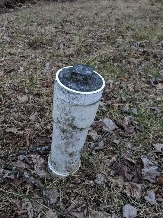

My house is connected to public sewer. There's a ~100ft setback between the house and the road, and in that area, there are two pipes I think are associated with the sewer. One is a white pipe coming out of the ground near the road that is well sealed, and the other is an open pipe that seems like it's meant to be allow airflow but keep rain out.
Here's that white pipe near the road: White pipe near road

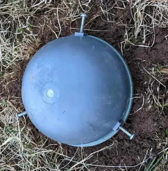

Here's the other pipe, same diameter, with its lid on and off: Sewer vent in yard with lid off
Sewer vent in yard with lid on
The issue, as shown in the last two images, is that the cap for the pipe near the house is not attached at all. The diameter of the cap is about the same as the diameter of the green fitting in the black pipe, so the cap's screws have no way to get into or under the green fitting. Also, the green fitting is snugly in the black pipe but it can easily be lifted up and out of the black pipe by hand. I'm unsure if that fitting is meant to be 'locked on' to the black pipe. We've had some very windy days and surprisingly, this went undisturbed and unnoticed.
How is this meant to be setup? What part do I need to swap out to remedy this? It seems like I just need a bigger cap so it can go over the green fitting and 'lock on' to it using the green screws. I'm assuming a 'snug' fit of the green fitting into the black pipe is sufficient.

  • Does seem like an air vent cap, so either it needs to be bigger or the base becomes smaller. If a vent, then it should fit over the bottom and vent down the sides. Those steps inside should fit the outside of the bottom piece. Might not even need the green piece if the top fits onto the pipe. – crip659 Jan 30 '23 at 00:05

Is it possible that you have a dry well? And that's an overflow?
The green fitting in the lawn looks like part of an overflow emitter - https://www.ndspro.com/products/drainage/pop-up-emitters.html
And the spherical cap looks like a mushroom vent cap. https://www.oatey.com/products/oatey-mushroom-vent-cap--1469620693
So I'd guess the center of the overflow got lost and someone dropped the vent cap on the hole to stop dirt/leaves washing down it.

The first one is a sewer cleanout. It's the last access point after your home plumbing but before the sewer drop dumps into the street line. The cap is so a plumber can access it with a snake or camera.
The second one looks to be an emitter connected to a stormwater drainage system. Generally your gutter downspouts are piped directly into PVC pipe and carried away from the foundation where the water can be discharged safely over the lawn. There is supposed to be another green plastic part on there that has broken off. The emitter caps are easy to find at hardware stores and usually just push into the pipe stub.

  • I confirmed that the pipe in between the house and the road, which had that emitter-looking cap on it, is access to the sewer pipe. So it seems we have two sewer cleanouts; one by the road, one in the yard + vent pipe coming out the roof. – cr0 Feb 06 '23 at 17:10
  • Probably someone broke the pipe with the emitter cap and just put on something they had or looked like it would fit. You should put a proper clean out cap on it. Then protect it somehow. And protect the other one, too. In my neighborhood, many of the clean outs are below ground level and in irrigation control boxes or similar. – longneck Feb 06 '23 at 19:36
