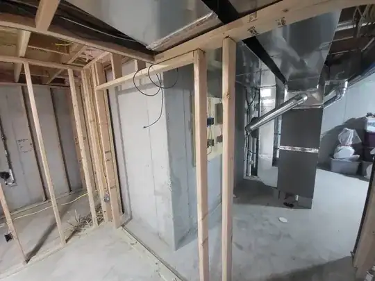

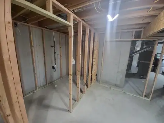

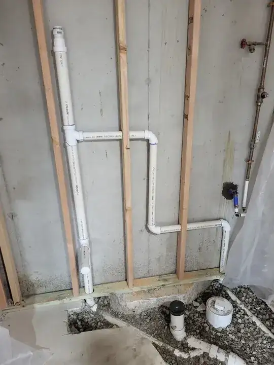

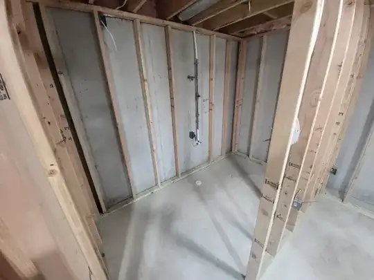

The space as is
Side wall
Corner
Stack View

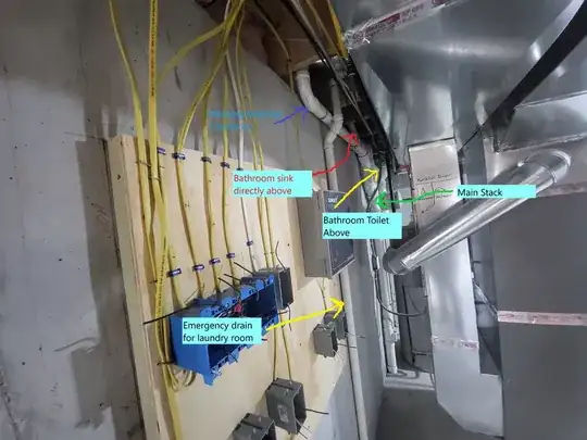

  • So, I'd have to find the line from the sink from the bathroom above that connects to the main stack, and not tie into the main stack at all, as it would have a toilet going to it? I added some pictures. – Kevinicus Feb 01 '23 at 17:23
  • That would depend on the size of that pipe and your applicable code. You might need to go further up to join a dry vent or section of stack (above the drains) that is a dry vent, or you might do better with something like the kitchen sink - depends on your plumbing layout and on your code. – Ecnerwal Feb 01 '23 at 17:42
  • Okay. I think that pipe is 2", but I'd have to measure. I think the kitchen sink is out as the stack it is on is across the house from that stack. And the 3rd stack only serves one bathroom on the top floor, so it'd have a toilet. It's looking more and more likely to me that I need to go out the wall, but I don't know how that will work either. – Kevinicus Feb 01 '23 at 18:10
