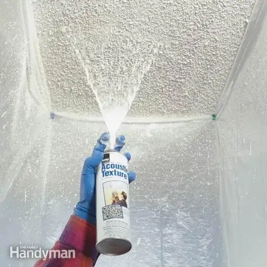

I've had similiar issues and have re-applied the popcorn to good results since my house has popcorn ceilings. You can certainly scrape off the popcorn for the entire ceiling and either re-apply it or smooth it out, but now the scope of the fix has increased.
Basically most home improvement stores sell popcorn spray in a can. @Tester101 has provided a link to one such product.
I can tell you from past experience that spraying on popcorn is not like spraying on paint.
  1. Tape off and cover surrounding area. This is a must as the overspray goes everywhere.
  2. Use short controlled bursts. I usually go forward, look at the results and then go back until the desired texture is achieved.
  3. Usually the product expels pretty quickly and somewhat uncontrollably from the can, so you might want to try a test run on a piece of plywood or other large flat surface to get the hang of it before tackling the actual area.
  4. I repaint the entire ceiling with flat ceiling paint after the fix is applied to make the finish uniform.
After that it hard to spot and will not be easily noticable unless you are actually looking for it.
