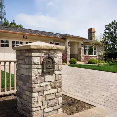

It occurred to me that this project might benefit from a single piece stone cap and eliminate lintel altogether. You could incorporate a bit of slope and weather proof the structure. A stone supply house could fashion it out of limestone.
More traditional lintel: This window drawing is pretty analogous to a mailbox opening:
You are probably building a double wythe wall, not a veneer, so an upside down 'T' is used
