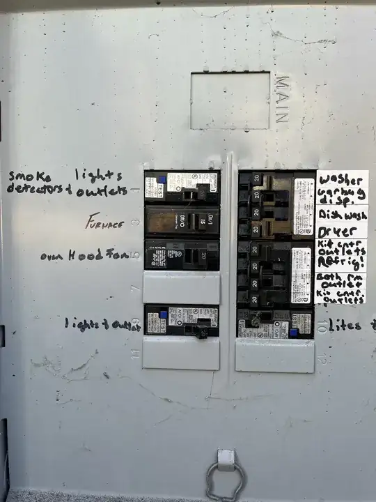

UPDATE: for those who asked what model of panel this is: It's a Murray LW1224L1125 Model 2 outdoor load center. I've also attached a photo of the existing circuit breaker setup and subpanel label.
subpanel circuit breakers
subpanel label
UPDATE 2: I've attached a photo of what I think is the same model of load center from here. As @jay613 pointed out in the comments, it looks like I made a faulty assumption that the subpanel had both lugs to connect the supply directly to the bus and also clips to attach a main breaker to, like the others. From the photo, it looks like you can only use one or the other approach, not both, so there's no way to add an additional breaker in the main breaker slot on this box.
Siemens LW1224L1125 load center interior

    Your tiny subpanel has two sets of bus lugs that can be used simultaneously? IE one with a main breaker and one without? – jay613 Feb 13 '23 at 18:28
  • @jay613 Good point. I was assuming there were two permanent lugs connected directly to the bus bars and also two tabs that a main breaker could clip onto. But in the (identical?) box at https://www.needco.com/product/detail/210175/SIEMENS-LW1224L1125, it looks like it is more of an either-or arrangement: you can either bolt lugs onto the top of the bus bars, or you can bolt a main breaker on, but not both. So I think that pretty much settles the question in this case! – Matthias Fripp Feb 14 '23 at 19:59

Update based on the panel label:
It is very clearly drawn (top diagram for main lug, bottom diagram for main breaker) and labeled ("either a main lug or a main breaker") to indicate that you can't use both the main breaker position and main lug feed. It would be possible to design such a thing, but there would be little point when the better answer from the manufacturer would be "move up to the next size panel".
The interesting question, which in a quick search I can't answer but maybe somebody else can, is breaker compatibility. Specifically, there are Siemens breakers that are legitimate for Murray panels (in fact, the Murray label here actually says it is made by Siemens). But what I don't know is whether or not you can transfer the existing Murray breakers to a new (much larger) Siemens panel. In particular, it would be very helpful to be able to move the AFCI breakers, as they are relatively expensive. In fact, those 3 AFCI breakers are roughly on par with either a large replacement panel or all the other breakers (2 quad, 2 single) put together.

You can use Siemens breakers, but you'll need to get a bigger panel
The good news is that your existing panel can legally and safely take Siemens QP breakers as they're the designated replacement type for the Murray MP series. The bad news is that that slot labeled "main" on your deadfront is useless to you since your panel's interior is designed to accept a backfed main breaker (in the top left branch positions), not a main breaker kit that replaces the main lugs. So, you'll need to get a bigger panel: since this is a subpanel, you can simply grab a 40-space or 42-space, 200A, main lug Siemens panel and roll with it.
