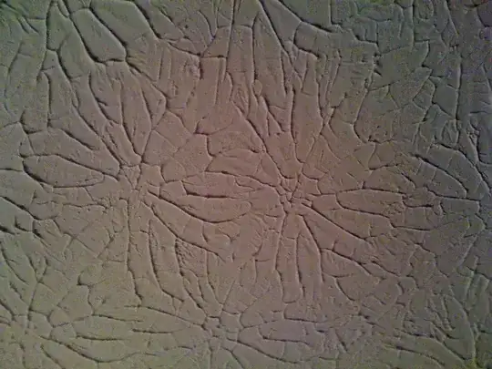

I had to cut access panels in the ceiling of a 7' x 11' room to make several plumbing repairs. The ceiling has the slapbrush/stomp texture:
I have patched the drywall and I plan on restomping the whole ceiling as opposed to trying to match a patch. After knocking off the brittle tips with a knife, can I simply roll on another coat of mud and stomp? The patches I made are smooth. Do I need to wet the ceiling down and knock it down with a knife or a sponge before I restomp to get the best results and hide the patches?

I would dampen the areas you patched, any areas that were/are painted won't absorb enough to matter.
If you are thinning premixed joint compound you should be able to roll it on and stomp. Cool pattern.

  • I just bought a brush at lunch to do this, but now I am wondering if I have the right one. How do I know which brush type did this design? – Evil Elf Apr 08 '13 at 17:22
  • Lol, I was going to ask what brush you'd used.. Time for a new question.. Some experimenting is in order. There are a LOT of designers over at houzz.com, post a pic there. – HerrBag Apr 08 '13 at 20:43
  • I think people call the design Rosebud. I don't think stomping a ceiling would be difficult, but it is in eyeshot of another ceiling, so I may get someone who knows what they are doing to try and match it. – Evil Elf Apr 09 '13 at 12:12
  • Another way might be to skim coat the whole room and use a different pattern.. – HerrBag Apr 09 '13 at 12:39
  • I just rolled on the mud as thick as I could and stomped it all. You can see the patched areas as the other areas have both patterns but it is pretty good. I think knocking it all down while moist would have helped hide the patches if I ever have to do it again. – Evil Elf May 08 '13 at 17:20
