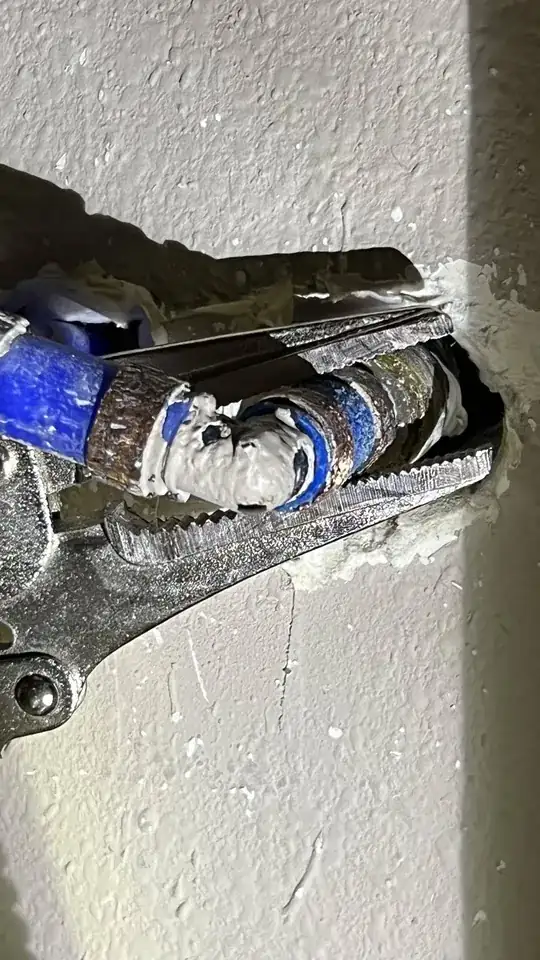

Trying to replace an outdoor spigot, that connects underneath kitchen sink. I have a pipe wrench on what I think is the attaching pipe, but the spigot just spins and spins and doesn't come loose? Wondering if it's soldered on, but then it shouldn't turn at all?
The Stem for the Spigot is in the wall, and connected to something (Gold/Brass) connector that looks connected to the copper threaded pipe?

  • I am not sure that it is threaded. Maybe its press fit. Is the outside smooth and round or does it look like a nut ? – Rohit Gupta Feb 15 '23 at 22:38
    Think those bronze/brass colour rings are crimp rings for pex pipe. Depending on type might need to be cut off. – crip659 Feb 15 '23 at 22:44
  • ok, thats what I was worried about. It's such a tight space with all the other kitchen sink pipes. It's going to be hard to get in and replace. – Sean McCully Feb 15 '23 at 22:49
  • If the rings are removed, the idea is that fitting should pop off. In real life in tight places, quite a bit of force/pulling(plus language not for children) is required. – crip659 Feb 15 '23 at 22:54
  • Thanks, will look into cutting crimp rings. – Sean McCully Feb 15 '23 at 22:57
  • Could you give another try at the picture and [edit] it in? There are lots of pixels but not much detail (focus or lighting is off, I think) when I zoom in, and I can't *really* see what's going on where it matters. – Ecnerwal Feb 15 '23 at 23:05
  • This appears to be a picture of the _inside_. Usually the spigot would be removed from the _outside_. How about a picture there - there's a good chance that you'll be able to get to it from outside. – FreeMan Feb 16 '23 at 12:55
  • @FreeMan a proper sill-cock for freezing areas extends all the way through the wall so that the valve is inside the house. – Ecnerwal Feb 16 '23 at 14:15
As best I can tell from "the sill-cocks I've met" and your picture, the sill-cock is a typical "threaded outside, solder inside" which has had a PEX fitting soldered in, inside and then crimped. It's not very clear but I think I see the outside male threads on the end of the sill-cock.
This is actually somewhat fortunate for you. When people try to unscrew these on a soldered copper pipe system, they twist the pipe they are attached to, and have more damage to repair. Since PEX fittings act like unions (the fitting turns inside the pipe and ring) you're just spinning, rather than damaging your other pipes.
I would suggest replacing with a PEX-FIP (female iron pipe threads) fitting so you can unscrew the next one. Here, you'll need to cut the copper crimp ring so you can remove the soldered in fitting and the attached sill-cock.
However: It's possible (picture is not great) that you may already have this, and just need to grab on the outside of the FIP fitting, if you have one. That would be a bit further into the hole than you are now, if you have a bronze/brass fitting that male threads from the sill-cock are going into. If I ignore the picture and read the text, that sounds like the case, so you need to grab that, not the crimp ring on the PEX connected to it.
    So the "sill-cock" had a PEX fitting soldered on, and I was able to replace by cutting the PEX pipe and Clamps and replacing the PEX and Clamp rings. Was a pain to do because it was underneath the sink. The original faucet had a unique thread on there that was designed to only fit one kinda of vacuum breaker which was why I was replacing it. – Sean McCully Feb 19 '23 at 20:50
To me that looks like quick connect/disconnect type.
It is not screwed, it is a insert.
Push/Pull the black ring and it will pop out'

That hose bib looks to be connected via pex. Turn off the water, cut the pex, pull the hose bib and get a frost-free version for replacement. You'll need pex rings, a 90 and a 1/2" crimp tool. You can get a crimp ring removal tool but unless you are doing a lot of plumbing it likely isn't worth it.
