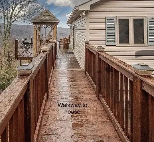

I'm using rope lights to illuminate a wooden walkway (a catwalk with railings, actually). I've put a string alongside each edge (at the bottom). Midway along the catwalk, there is single step about 6" high. I want to illuminate it for safety, and I'm not sure how best to do it.
  1. I've zip-tied the rope light along the front edge of the step's nosing. I've got it very straight and tight against the nose, and it looks good. I'm afraid, however, that footfalls, rolling over the front edge of the nose, will loosen it so it becomes a trip hazard and/or the lights are damaged.
  2. Route a groove a little ways back from the edge, that the rope lights will fit snugly into - maybe cement it with RTV silicone. I think it'll be good for people stepping up, but I'm not so sure about stepping down.
  3. Put it along the bottom of the riser (in the corner between the lower-level of the walkway and the step). I'm thinking this could be best. I think it'll provide great illumination for stepping up, and should also provide a good visual cue for stepping down, although it doesn't explicitly mark the nose. It shouldn't present any trip hazard either.
Maybe I just need to experiment. But I'd welcome insight or other ideas.

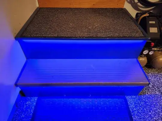

An example of under-the-nose lighting. This was installed shortly after a friend broke her foot in someone else's garage when she missed a single step between bays.
Garage steps: Garage Steps
Bottom view: Bottom View
Bottom view of both steps in the dark: Bottom View Of Both Steps In The Dark
View from doorway: View From Doorway
View from standing in garage: enter image description here
Apologies for the quick and dirty snapshots. And yes, those are blue LED strips.

  • Added a picture. – RustyShackleford Feb 16 '23 at 17:45
    I might add some distinctive extra lamps at the point of the step. This tells the user that "something's different here" and minimise the chance of forgetting the step from either direction. Maybe a decorative fixture, maybe use some different colour, perhaps even an arch over this spot with a single god-light straight down at the step so it looks like a street light with a pool of light under it. – Criggie Feb 17 '23 at 01:37
    Come to think of it, those floodlights (in the picture) are positioned to aim at the step. Duh. – RustyShackleford Feb 17 '23 at 03:34
