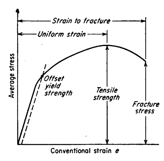

All steel has a Young's Modulus of 200 GPa (29 000 ksi) (This is the slope of the straight part of the graph) . Ultimate Strength runs from 300 - 400 MPa (peek of the graph), and the Yield is usually around 200 MPa (Where straight becomes curved).
In a test machine, you can stretch and shrink a steel bar up and down that straight part of the graph forever (Well, fatigue will kick in). But once you get into the curved part, unloading will follow a different path (See dashed line).
For structural purposes Yield strength is the limiting factor. In other words, you want your design to be limited entirely to the elastic (straight) region of the Stress/Strain chart. If you go into the plastic region, you're permanently deforming the material. (Although aircraft designers go well into the plastic region for reasons of weight). enter image description here
