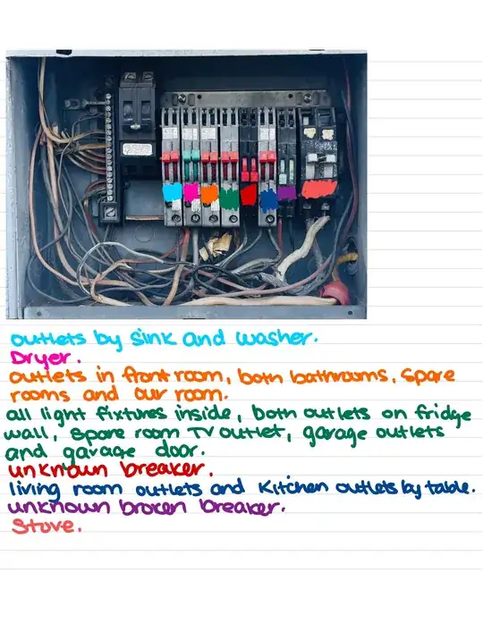

The power in several rooms has randomly gone out then comes back on seconds later. We consulted with an electrician that told us to replace the whole panel but we can’t afford $5000 to do that right now so instead we decided to replace the problem breakers. When my husband turned off the main breaker to replace the others it sparked a little. While replacing the first breaker he bumped the main breaker still in the off position and it sparked some more. If we replace the main breaker will this remedy the problem??? Also in the picture the two breakers in the off position we have no idea what they power.The breakers we are replacing are from left to right, the first 3 20amp breakers.

    Where are you located? Where I live (Dallss TX) it would not cost $5k to replace a basic panel. Howver, it is possible that replacing a panel might trigger a provision that the entire system be brought up to current code and this could be expensive. – Jim Stewart Feb 20 '23 at 17:30
    I live in Northern California. – Stacie Feb 20 '23 at 17:32
    Ever heard the phrase "accident waiting to happen"? Get another quote / price from a different electrician. – Solar Mike Feb 20 '23 at 17:34
    Sparking main breaker plus the picture of the panel I believe gives you reason to replace right now. Have the power company turn off the power and you can do most of the changing with an electrician inspecting. – crip659 Feb 20 '23 at 17:38
    Replace the whole panel? – Stacie Feb 20 '23 at 17:40
    I think that is one of the known bad panels that is dangerous to have. They have been known to burn up, and most of the breakers do not trip when there is a problem. – crip659 Feb 20 '23 at 17:40
    Thanks for the info. – Stacie Feb 20 '23 at 17:43
  • 27
    That is a Zinsco panel. They are notorious for bus arcing and breakers that don't trip when they should (fatal design, replacements won't help). See https://diy.stackexchange.com/questions/193809/ You need to replace it ASAP before it burns your house down. – nobody Feb 20 '23 at 17:44
    That was the name I could not think of. They are a bad design. The breakers do not trip on shorts but tend to burn. If a breaker does trip, it is lucky. – crip659 Feb 20 '23 at 17:44
    Damn ok I was hoping this would be a simple fix. Thank you! I will tell my husband the whole things gotta go. – Stacie Feb 20 '23 at 17:45

This is a ZINSCO fire-starter panel. It's gotta go.
It's not old; it was built defective. The breakers are defective. The bus design is also defective, so even if magic safe breakers could be obtained, the bus is no good.
It cannot be fixed by replacing breakers; that's throwing good money after bad.
Whoever quoted $5000 is clearly "naysaying", that's a highball quote specifically so you could use it as an excuse not to do the work. If that's how local electricians want to be, then for Pete's sake this panel only has 9 circuits in it! I'd hit the library and read every book they have on home electrical, cover to cover... and see if it's something you could DIY.

Unfortunately, you have a Zinsco panel. These are known to have problems, and the problems you describe are symptomatic, and dangerous.
In some panels, problem breakers can be replaced with newer, more reliable, breakers. As I understand it, the replacement breakers available for these panels are not necessarily any better, and really the only proper thing to do is replace the panel.

When (not "if") you replace the panel, consider a much larger panel. By my count, excluding the main breaker and the unknowns, you have 12 breakers in use. That's including at least 2 (dryer, stove) that are really double-breakers and not two single breakers. Translated into a new panel and, at least initially, avoiding "1/2 size/tandem" breakers, that means 12 spaces. Do not get a 12 space panel. Assuming you have the physical space for it, get at least a 20 space panel, in order to have room for future expansion. Make sure it is 20 spaces, not 20 circuits. "20 spaces/40 circuits" is OK, "12 spaces/24 circuits" is not. Larger, if you have the physical space, is even better.
